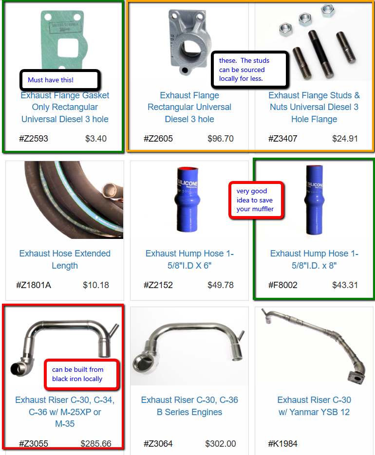

If it is like mine, the elbow is made from black iron gas pipe and fittings. The "mixing" part is a short pipe welded into a close nipple. When I did mine, everything was in good shape except for some buildup. I cleaned it out and reinstalled. To remove it, you will need to remove the exhaust flange and you will need to replace the gasket at least. I was lucky and careful and it came off without any damage but others have broken the flange studs and/or the flange. It is also a very good idea to install a hump hose to isolate the engine vibration from the water-lift to prevent damage to it. Exhaust System
That’s good to hear. Not sure what mine is made of yet. I’ll keep my fingers crossed I can do the same. I probably can’t get to it now for another week.

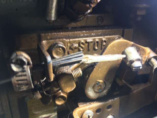

Found my problem! Turns out my engine stop cable was McGuyver’d and failed in a way where it wasn’t totally opening back up fully.
so, I’m going to replace it. Does anybody know if the 20’ one that Catalina direct sells is already the correct length?

After some thought, the statement on CD’s website (may be trimmed to fit) makes me think that’s how this got that way. It was likely replaced and was never properly terminated. The cable overall looks okay, it just needs a proper ferrule on the end. id like to explore fixing the end first.
Can’t believe this was my issue all along. It makes total sense how the engine ran fine till I stopped it and restarted. And now it starts right up like normal. Crazy...
I’m glad you guys made me check the exhaust elbow though. One less future failure to worry about now.

Yes. It was insane. Now tied up at the slip I can get up to 2600-2700 or higher RPM in gear. I was getting 1900-2000 before. It was immediately obvious that this solved the issue.
It explains why the fuel pump tested fine, the in/out air made no difference, and why sometimes it went a little more or less on max RPM.
I have to give credit to my friend. He came over to help me do a last go-over on this motor issue, brought a compression tester and digital tach. I was showing him the throttle mechanism and he noticed the fuel stop cable going through the bracket like that and said “what’s going on here?” And the rest is history.
We high five’d, cracked a beer and celebrated.

I have the same model - '88 mkII. Its hard to tell whats going on and the condition of the cable, but can tell you that the screw looking stopper on your cable goes on the OTHER side of the lever.
fyi I had my stop cable replaced last season, my boat yard replaced it and they used an LU33 20ft cable, and they had to trim it slightly to fit. It was a 2hr job. Here is a link to the part if you decide to go that route.
