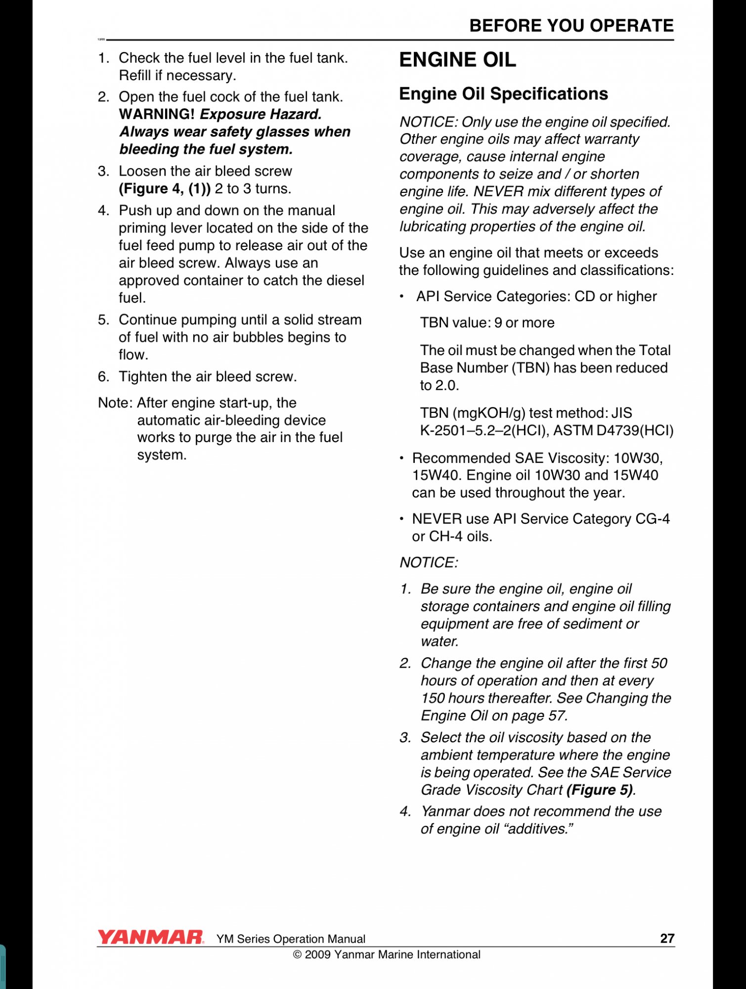

Attached, look at the Yanmar book, and the 3rd bullet point. "NEVER.... CH-4"

So I presume the manual means not to use an oil that's *only* certified to the CG-4 or CH-4 level. Seems like the higher grades provide the extra qualities that the engine requires.

Look for the date of printing of the manual. There have been great improvements in oils in recent years and certain categories are dropped or included in higher grades. It is quite common to look at the boat manuals and find the recommended oil is not even available at this time. The Shell Rotella 15W40 exceeds your engine's requirements.
