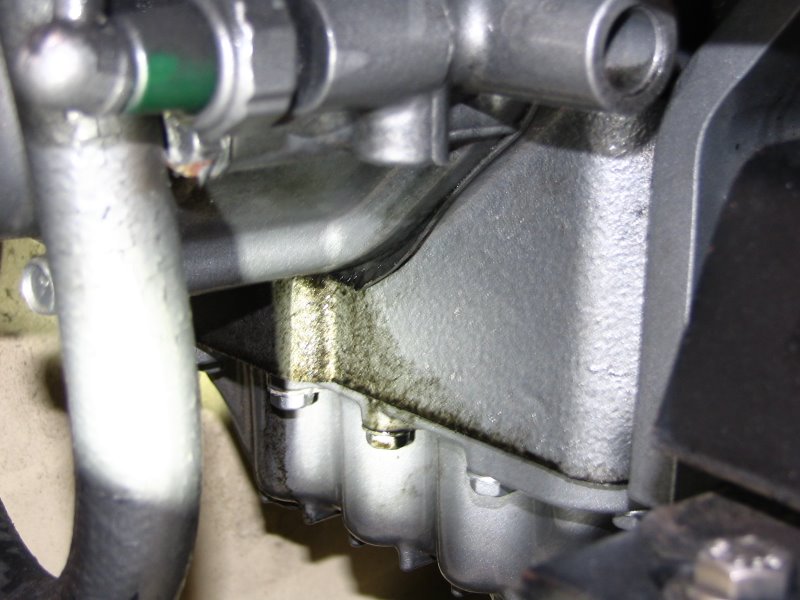

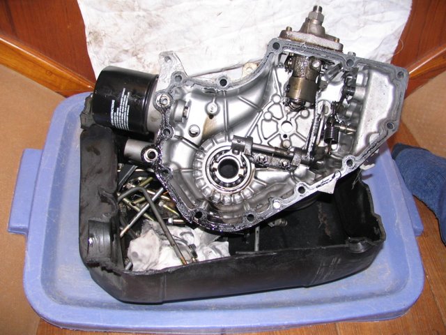

Possibly I have an idea. Check the interface between the front cover of the engine and the block. The gasket fails and oil runs down at the bottom, then under the oil pan where it drips off and then runs back forward on the fiberglass pan. How do I know? That was this past February's project.
If this is the case, check out the attached pictures and the .pdf file should give you everything you need to change the gasket. I followed this procedure myself and the total cost of repair was $38.00. It took me about 6 hours.

I've had 3 oil leaks before. First was hand cranking shaft oil seal leaking. Easy fix. Pry out seal and pop in new ones. 2nd was exactly what Allan said. Quite frightening job to do at first. But after done...hey it wasn't that difficult job after all. 3rd was the valve cover gasket (rubber ring) leaks. Easy fix.
