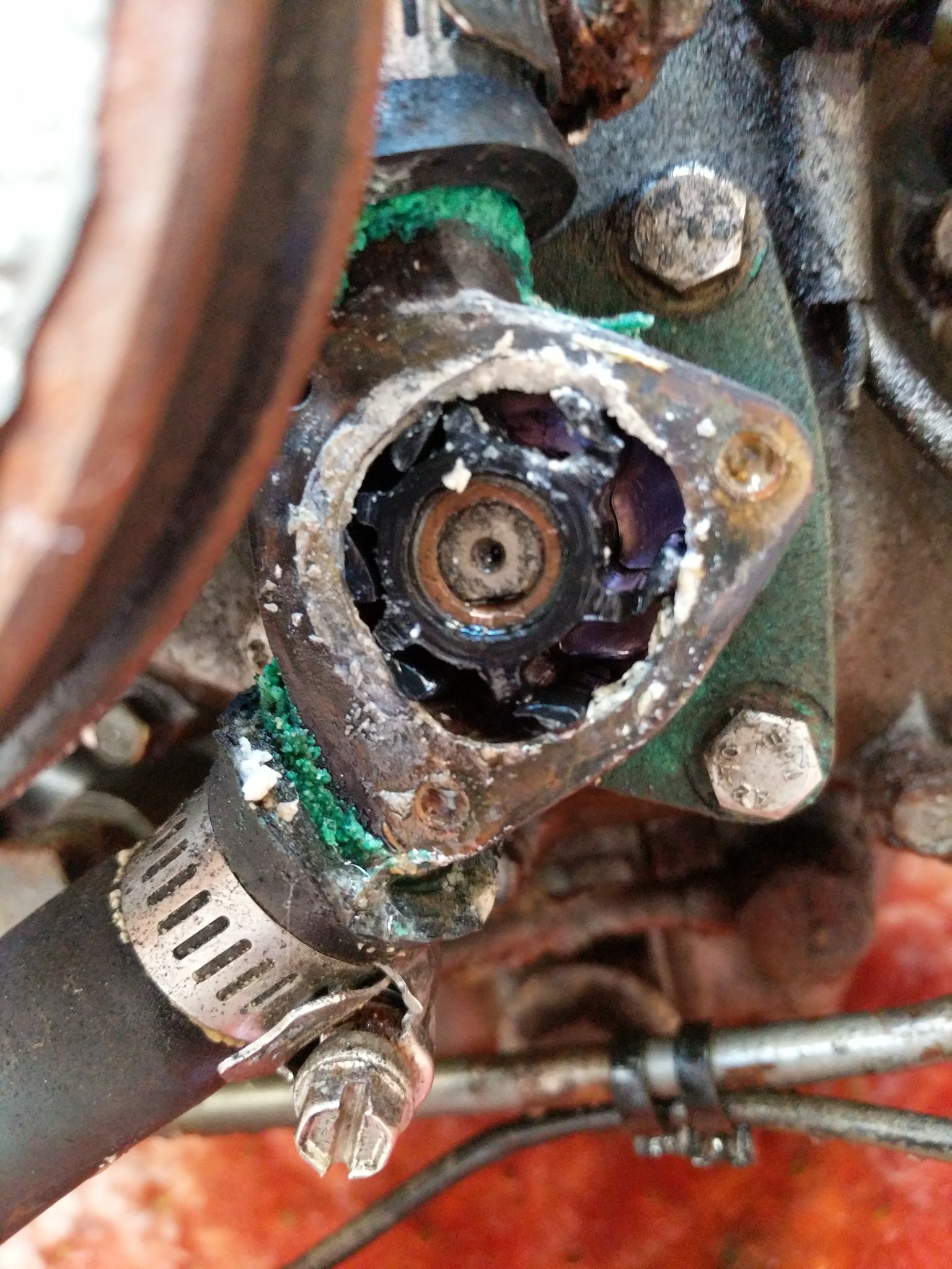

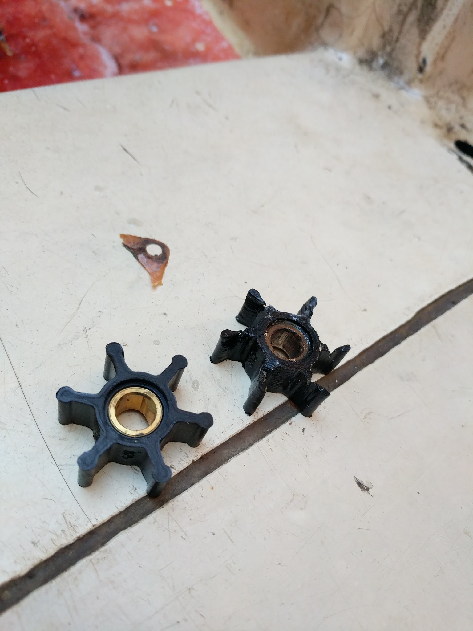

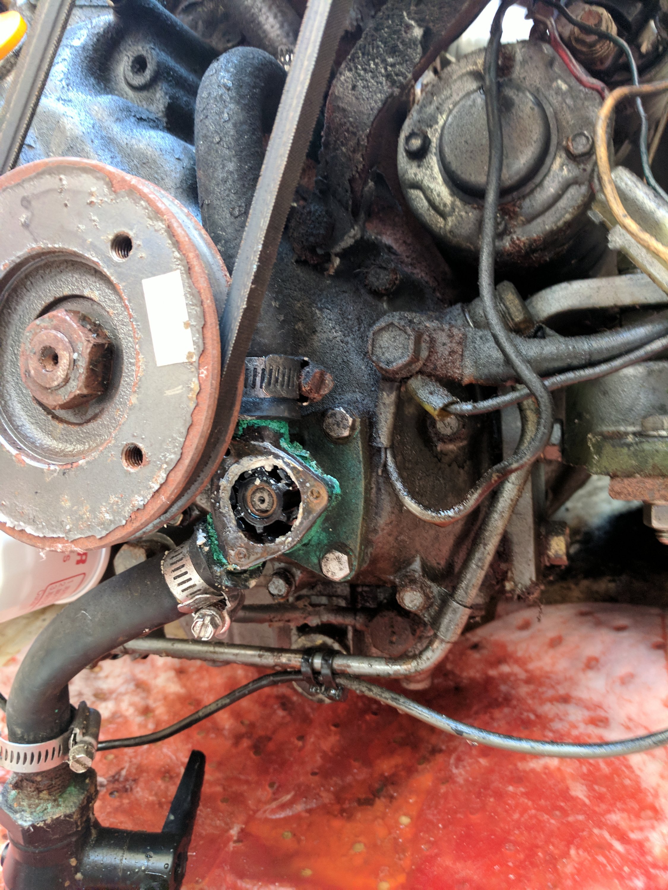

I ended up changing the impeller because when I opened up the impeller housing - it was pretty bad so I'm pretty sure the engine wasn't getting water.
After that I was still hearing the noise, so I took the advise and took the belt off and boom!, noise went away.
I checked the alternator and it rotates freely without any vibration or noise. So I adjusted the tension by pretty much maxing out the distance on the alternator arm. When I tested it again, there was no noise, so I'm guessing it was the belt tension.
The good thing, I managed to change oil and oil filter and impeller and clean up the impeller housing too - all for the first time.
I will probably stop by the yanmar dealer and get another belt just in case if this one is wrong length since I'm at the max distance on the alternator arm. I looked at the belt itself and it looked good, no cracks or damage but who knows, it could be the wrong belt period. Pretty easy to change them.
Thank you again everybody:
Here are some pics of how bad the impeller was and the housing:
