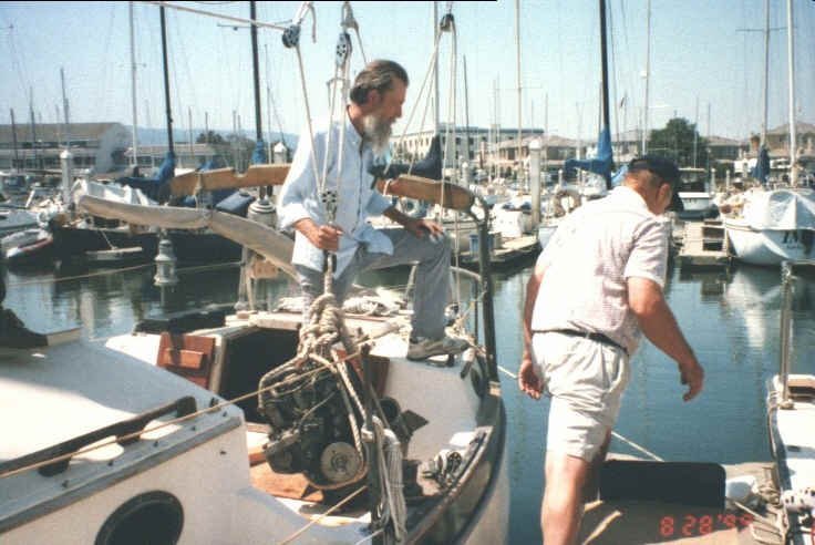

We used
our boom.
We swung out the old engine (photo below) to the finger dock, and just reversed it to get the new one in. Just make sure to tie the halyard or topping lift to the same area of the boom where you are putting the line to lift the engine.
We swapped out a Yanmar 2QM15 for a new 2GM20F
