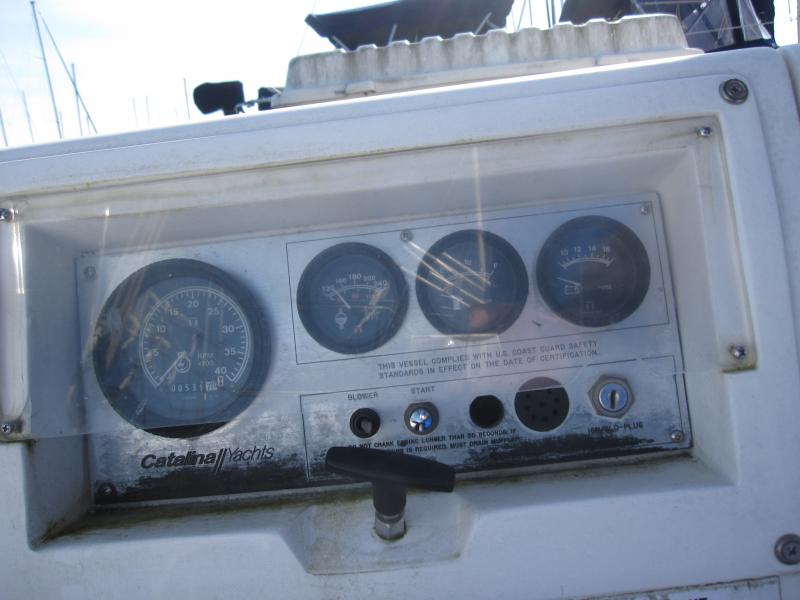

Mincing words. You feel yours is improvidently located. You either decide to live with it where it is, get a new panel that has the cable located as in Doug's picture, or relocate to a more convenient place that does not stress the panel. I can't think of any other choices except to buy a new 41 footer.

what is a glo plug button? and why would pushing and pulling a cable whose outer skin runs through the panel stress the panel? when i use my cut off cable it puts no force on the panel, and no force, no stress.
