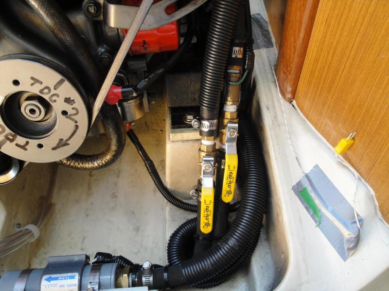

Thanks I did a search before the post and came up with nothing. I need to go online and see what I can find also. Just wanted to see if anyone had done this already.Do a search in this forum for more info on sailors who have done what you want and have seen most put a tee with temp sender in water hose close to water pump or thermostat.
But be careful with a tee for oil pressure as I did that and year later it cracked and almost blew up my motor.

Here is the link to what worked well with my engine.I have a 1998 Hunter 376. The boat doesn't have an instrument that shows engine temperature or Oil Pressure. I would like to add these instrument has anyone done this? If yes I would love to know how, advice, pictures, etc.
