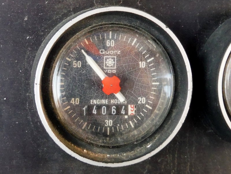

I'll take the 3000 hour 20 year old well maintained engine over the 200 hour 20 year old poorly maintained engine every day of the week. I have numerous customers out there with 8k - 14k + hours and some commeccial fishemen with over 20,000 hours with no re-builds.
I have posted this before but here it is again...
My buddy Darren owns a good sized excavating, irrigation and landscaping company in Colorado and we talk diesels quite a bit. He has a good sized fleet of diesel equipment and a couple of them have over 20k hours with no rebuilds. The last time I spoke with him about engine longevity he had one Yanmar block and one Mitsubishi block with over 20k hours. He bought both of these machines used with about 5k hours on them back in the late 90's. Neither engine has needed a rebuild and these are the identical industrial engine blocks to the ones we use in marine applications..
Most of his smaller engines are either Yanmar or Kubota but he does have a few Mitsubishi's too. His engines run all day and basically never shut off. They idle for long, long, long hours. Now granted these are not in a marine application but in well over 500,000 hours of combined run time on his fleet he has yet to rebuild an single small diesel engine. All his machines run Shell Rotella (not synthetic) and it gets changed regularly. Of course he buys his oil in 55 gal drums and I buy it by the gallon...
If heavy equipment running Yanmar, Mitsubishi and Kubota blocks can rack up10k to 20k hours, while doing hundreds and hundreds of hours of idling per year, with no rebuilds, then a well maintained marine diesel can do the same. Our Westerbeke is well over 4000 hours and much of this is engine driven refrigeration hours.
When we had the discussion about not letting diesels idle a few years ago he just laughed about the glazing the cylinder walls. His sarcastic comment was something like "Sh&t I better let my guys know not to let them idle". Course he'd already been doing it for 20 some odd years, with no failed engines or rebuilds needed, so he was surprised to find out his engines were going to die soon from light loading.
Our engine has idled perhaps half or more of its 4000+ hours. It burns zero oil, has cross hatching in the bores that looks like new and she purrs like a kitten. We have Sea Frost and often sail with the engine idling or will let it idle to chill the plate if we are alone and not disturbing others. Our boat also did a five year 24/7 on-the-hook almost circumnavigation. She had no generator and only the alt and a single solar panel. That racked up the majority of the current hours.
This customers engine is still going strong today, no rebuilds, and this picture was taken in 2014..
