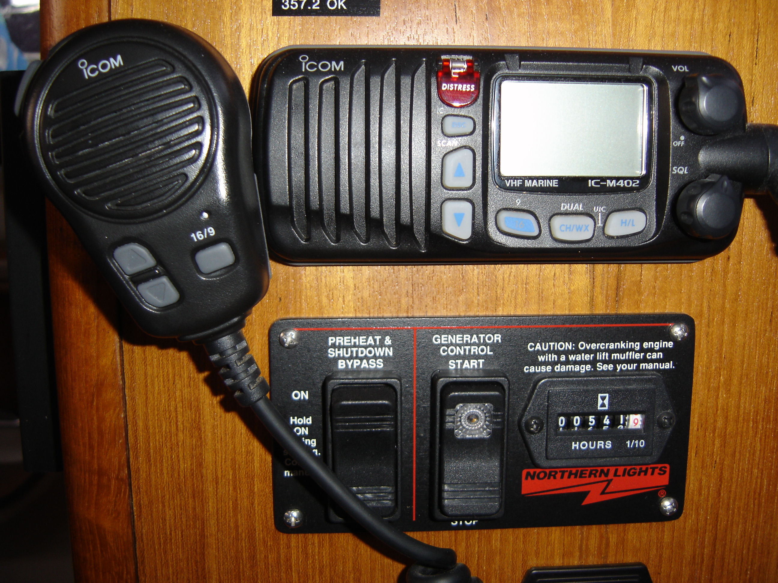

My 356 has the hobbs hour meter mounted in the Nav station. It is not digital, but the old rotating dial type. I did have a problem with my generator Hobbs when it hit 2000 hours, it got hung up. I bought a new one to replace it, but by the time it came in and I was ready to replace it, it started working again. I just add a little over 7 hours to the number on the Hobbs and it is correct. Both of these Hobbs meters seem to agree. The photo below is the Hobbs meter for the Northern Lights generator. The Yanmar is just below in the same panel. You can barely see the top edge just below and to the right.
