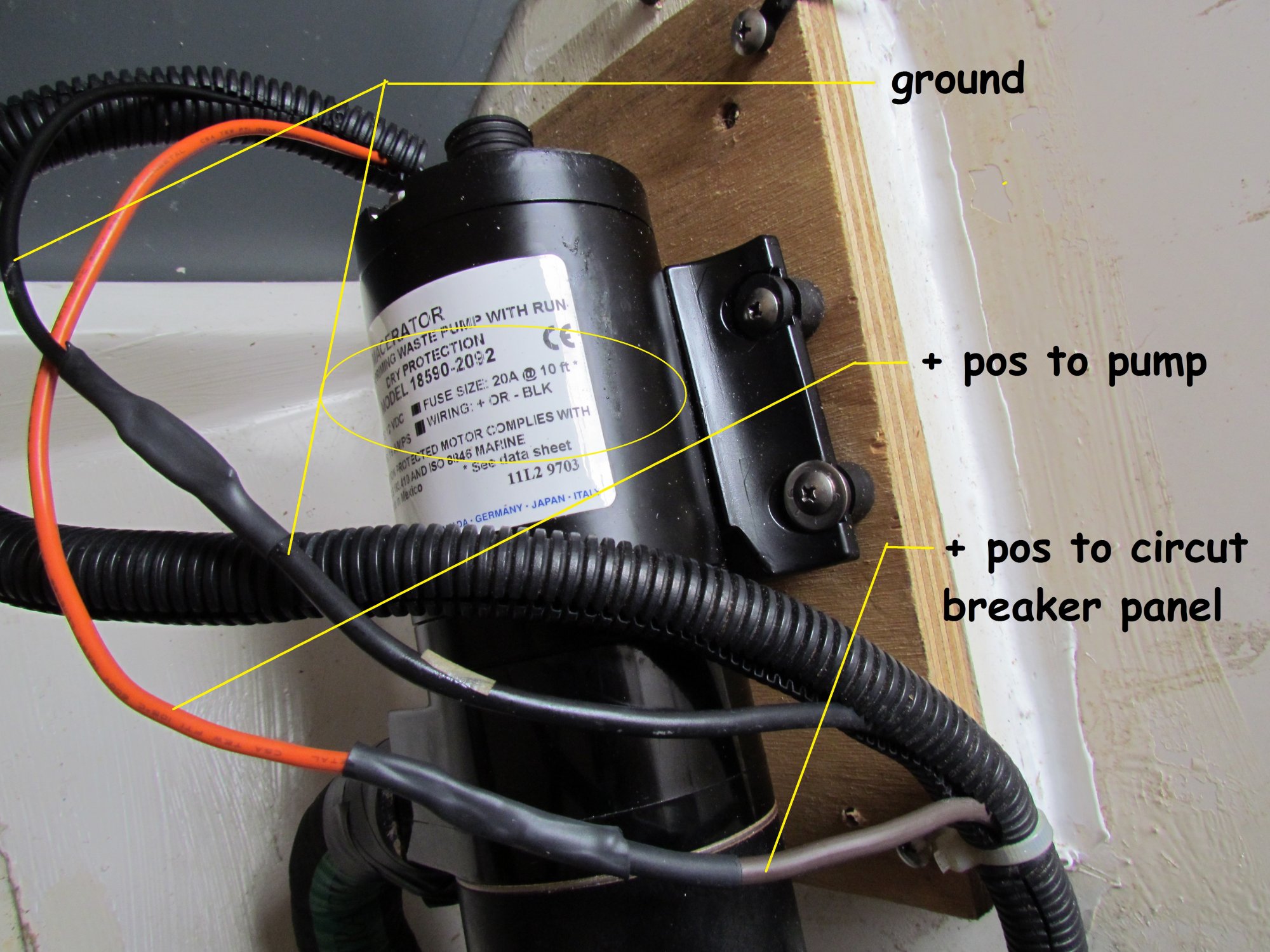

Well if you turn on the macerator switch and it does not pump out the holding tank... you head out for the nearest pump out and look for a new pump.
Placing this sign over the head will cut down on the macerator replacements.
Also, there is a small screw on the pump body which you can use to force the rotor to rotate. This will tell you what's wrong with the macerator.
Twenty years of cruising with two teenage granddaughters and an endless lineup of female friends ....................... one replacement macerator at 18 years because of a leaking shaft seal.
