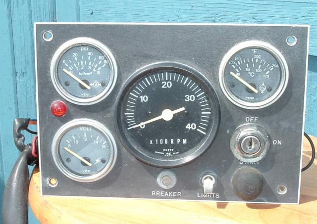

I have the same question, although I am adding oil, temp, volt & not replacing. My parts guy suggests & sells VDO saying they're the best.

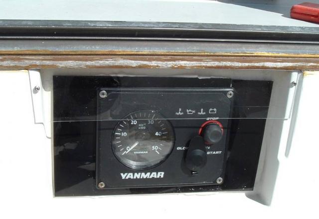

When I bought my '79 Hunter it had a VDO panel with all the gauges and tach. Now with my new 3YM30 Yanmar I have the basic Yanmar panel. The VDO panel was never a problem. Wish I could have adapted it. Sorry but I sold it with the 2QM20.

I added oil pressure and voltage gauges to my helm station, and used VDO with new senders. Made the pods from PVC pipe caps and bits of teak.
