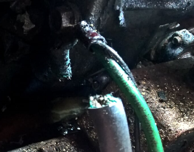

With the Yanmar (YGM20 1986 oDay 322) getting 'crankier' with each start AND I'd already beefed up the starter solenoid wire and replaced the button I decided I needed to replace the starter. Not as easy as you'd think cuz there is no access to the port side of the motor without roto-zipping an access port in the head.
The roto-zipping went easily enough and when I removed the panel I was surprised to see that the main grounding cable to the battery banks was completely rotted away, seems marine grade wiring was an option the original owner overlooked.
The starter was only grounded thru the much smaller ground wire (source unknown) as was the rest of the boat!
It turns out that for about $80 at We$tmarine you can get real marine grade 12" #2 wire and amazingly it can be pulled (from the battery box end) by securing the dead end to the new cable. The only real turn seems to be at the battery box. (striping back the rotted end didn't reveal any fresh copper)
While there anyway I decided to do something about the starter.
The local Yanmar dealer offered to sell me a new starter for $475 which would last 30 years longer that the rest of the boat so I opted for a local rebuild shop who gave me 1 day turn around, new bushings and a upgraded solenoid and a new paint job for $140.
Anyway, Blue Skies now starts like new and except for an ugly mess when the roto-zip and I had a argument all is well.

So Pat, was the gray cable on the left your ground? Is that how your found it? What are the green and smaller wire? Is that the ground that you said was the only thing helping you start the engine?
23,544
Nice report and nice job, thanks.
For other readers: That's one reason why many boating communities are suggesting that hard starting issues should usually first be traced to the ground wire, especially the connection at the engine, if not the wire itself.

Hi Stu, As a log time back yard mechanic and one time navy electrician I like to tell people that at least 1/2 of all 12 volt electrical problems are the ground! ;-)

Yep the 'fat " wire is a #2 directly to the battery terminal ground post. I didn't chase the green wire #10? but I likely goes to the electrical panel.

No, the paint job on the starter was Yanmar grey, I try to remove all blood before taking pictures. The only roto-zip issue was bad planning, followed by a loss of patience, and some unsightly carpentry. Fortunately duck tape comes in oDay grey and I hang my washboards in the head, hiding my shame from public view.

The grey ground wire was completely disconnected as I found it. I pulled it out for the photo.
