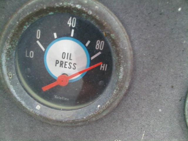

Hi everyone,
I recently noticed my oil pressure gauge is very high when im giving the engine gas. I attached a few pictures. Also there is a picture of my AMP gauge and I dont think it works. What is the AMP gauge for and where does it hook up too?

the oil pressure gauge is connected to a sending unit screwed into the engine block and how accurate it and the gauge is should be questionable if its old...you could get a mechanical gauge and screw it in where the sending unit is to get a true reading and baseline to see how accurate your gauge is

cnsmith-I would disconnect the oil pressure gauge at the engine and install one directly to the engine as a diagnosis tool. The gauge will cost you $10-$20. The most difficult part will be determining the thread size in the engine(and that is not that hard). If you buy a gauge at an auto parts store you can get them that have different sized adapters in the kit.
Oil pressure and temperature are two things you don't take chances with.

Might not be HIGH cause the way the gauge works is from wiring from the engine sending unit to the gauge BUT if there's an issue with the gauge OR the wiring then you'll see it pinned to the high side.....I would bet on a wiring issue.....read the above posts about testing the oil pressure

The oil pressure gauge on the Atomic 4 that I took out of Bietzpadlin used a small tube from the port to the gauge. What I don't know is if the gauge is bewteen the oil pump and the oil filter or after the oil filter. When did you last change the oil filter? The next step as stated is to change the gauge.

The oil pressure sensor is a variable resistor. The gage is just an ohm meter calibrated to read oil pressure. SO... if you have a high resistance due to (gasp it can't be, not again) corrosion the gage is going to read off. If memory serves the higher the resistance the higher the gage reads. Check all the connectors between the gage and sensor and the sensor to engine (engine acts as ground) and the engine ground to battery for corrosion. 99.44% of all electrical problems on boats is corroded connections.

Maybe the filter is clogged. might be worth changing it just to check. A cheap mechanical gauge like Hermit suggests is handy to keep around too. I bought a couple at the local hardware store. I will venture to guess that the thread size for the Atomic 4 is 1/8" pipe thread. Get one that is 0-100 psi and screw it in place of the oil sender on the engine and start it up. That will help direct you to the proper solution.
