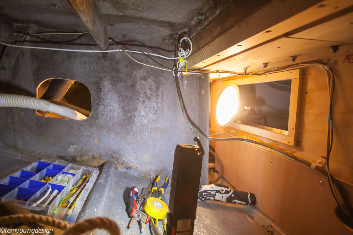

I installed a new water-lift muffler and exhaust on my boat two years ago and put a high loop in the lazerette on the centerline. You can see the loop through the access hole I had to enlarge in a bulkhead on the centerline of the lazarette.
If the high loop goes to one side or the other, 50% of the time it won't be a high loop and could potentially flood the engine, especially on a hull like mine (which is very similar to your Bristol 29).

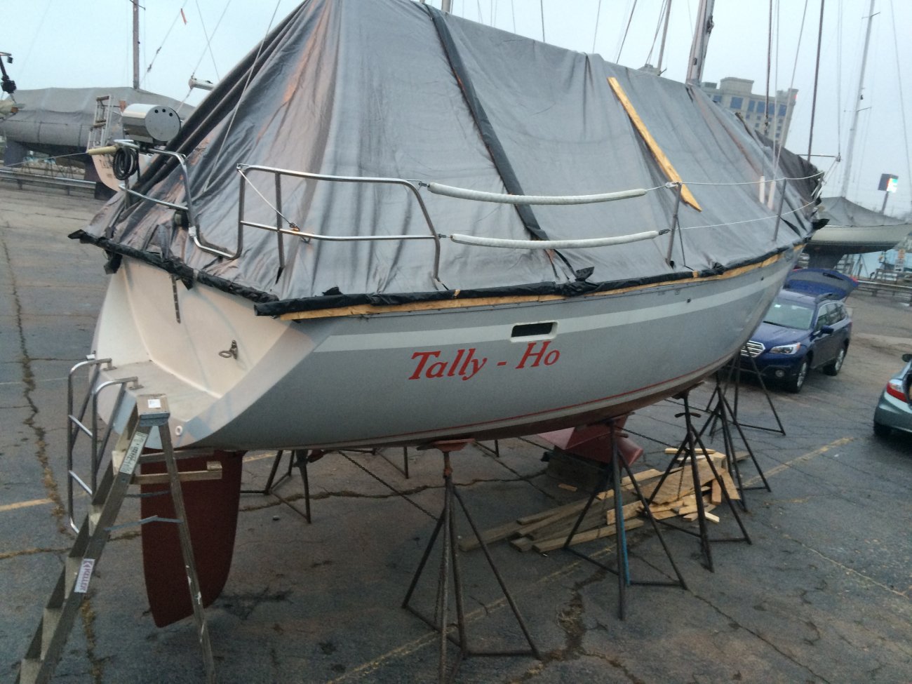

My 1996 Hunter 280 had a Yanmar 2GM20F that exhausted under the boat, below the waterline.
My current 1988 O’Day 322 also has the 2GM20F, but the exhaust is above the waterline, on the port side transom...very close to the outside edge of the hull. Might be able to see it on the port side in the photo below.
