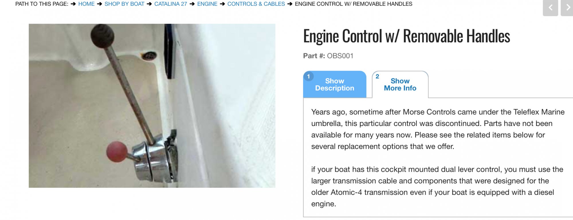

interesting discovery while looking for the single lever. CatalinaDirect has the perfect replacement except it doesn't work with my 5411 engine.
"This control will not work with the model 5411 engine. Unlike other engines that have a separate cable to facilitate engine shut-off, the 5411 requires the throttle lever be held farther aft than idle against a spring detent to kill the engine. Since a single lever control increases engine speed if moved either forward or aft from the neutral position, there is no way to kill the engine. You must use the #Z2595 control to facilitate engine stop by by use of the throttle."
