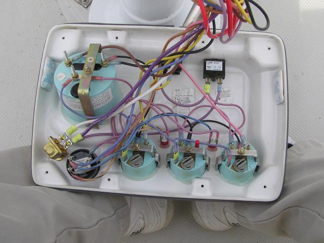

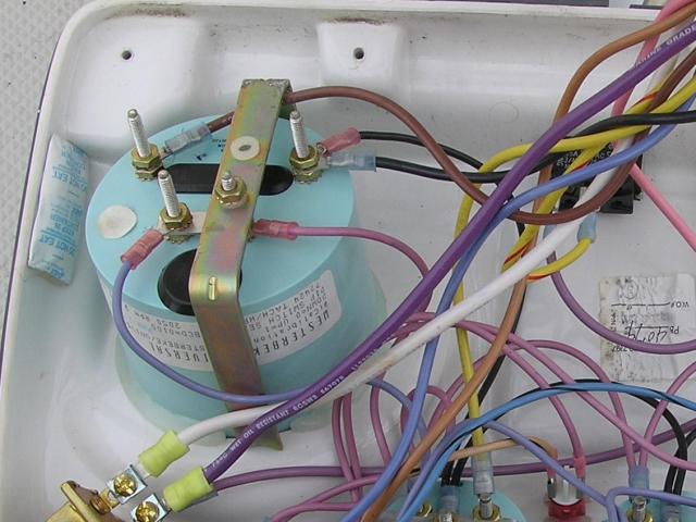

There is a light bulb for every instrument
In my case the light inside the tachometer burned out. When you open your console on the back of the tachometer is a round black cover. You pop that off and you can then see the bulb in it's mount. The other 4 instruments (oil pressure, temperature, voltage, and ...) have their bulbs out in the open.
