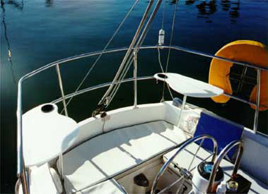

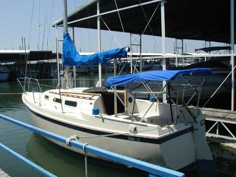

Can you share pictures please
Sorry, I was not remembering the vents correctly (it's been a while), they were actually on top of the transom, you can see one in this picture. I still think you could place them on the stern, up high.

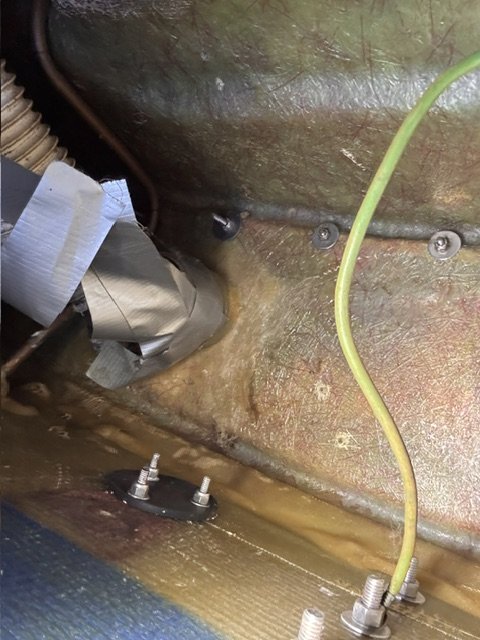

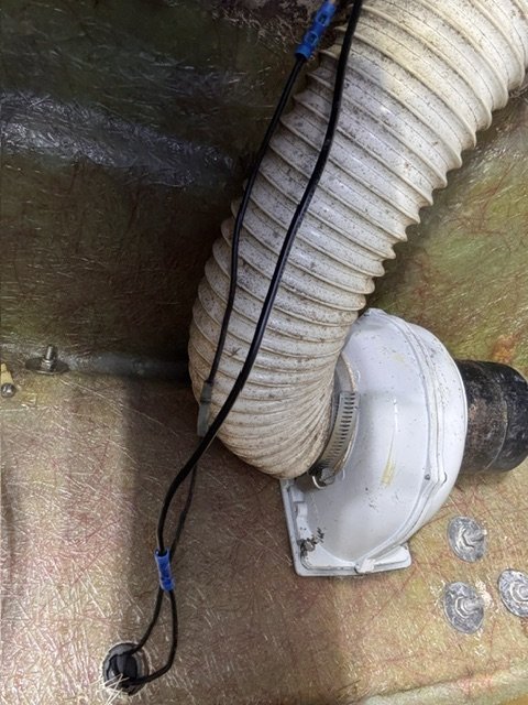

I will be installing them on the stern.
I had a good look inside the stern lazarette and it will be easy to do!
The blower and hoses are pointing up
