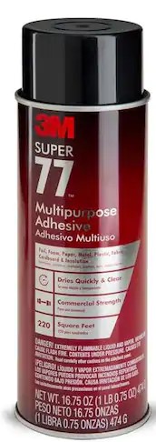

I use the 3M Super 77 Adhesive. Available many hardware stores, street price about $10. It is the same product that Soundown supplies. But I agree that attaching to side pieces with the mylar tape will add additional holding power. For overhead or really difficult pieces to hold, Soundown makes a pin with a base that is epoxied to the compartment surface. The insulation is then impaled on the pin and a push cap is installed. Those work very well but are difficult to install with limited access.

The 3M Super 77 or 90 works well and is usually a permanent solution. You'll definitely need a good mask
