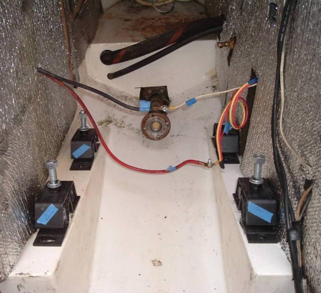

Although my boat's engine box is factory lined with the foil covered foam that Ed Schenck posted a picture of (and mine also is going strong after 30 years!), I added some of the automotive deadener to the underside of the cockpit sole (the ceiling of the sound box). As it did with my car, the stuff made a really noticeable improvement in engine noise while in the cockpit. One aspect about this product, vs. the foam variation, is that it provides dampening mass to panels which stops them from resonating like a drum. I am planning to add some more deadener around the inside of my lazarette areas which I know are resonating from the engine noise and vibration. Also, I'll install some to the outside of the engine compartment box to further dampen the noise/resonance.
The website says heat resistance is to 300F. The aluminun foil coating is quite thick. I can't comment on if it meets marine fire retardent standards. I would think however that the black foam marine product would be flamable at high temperatures as well.
