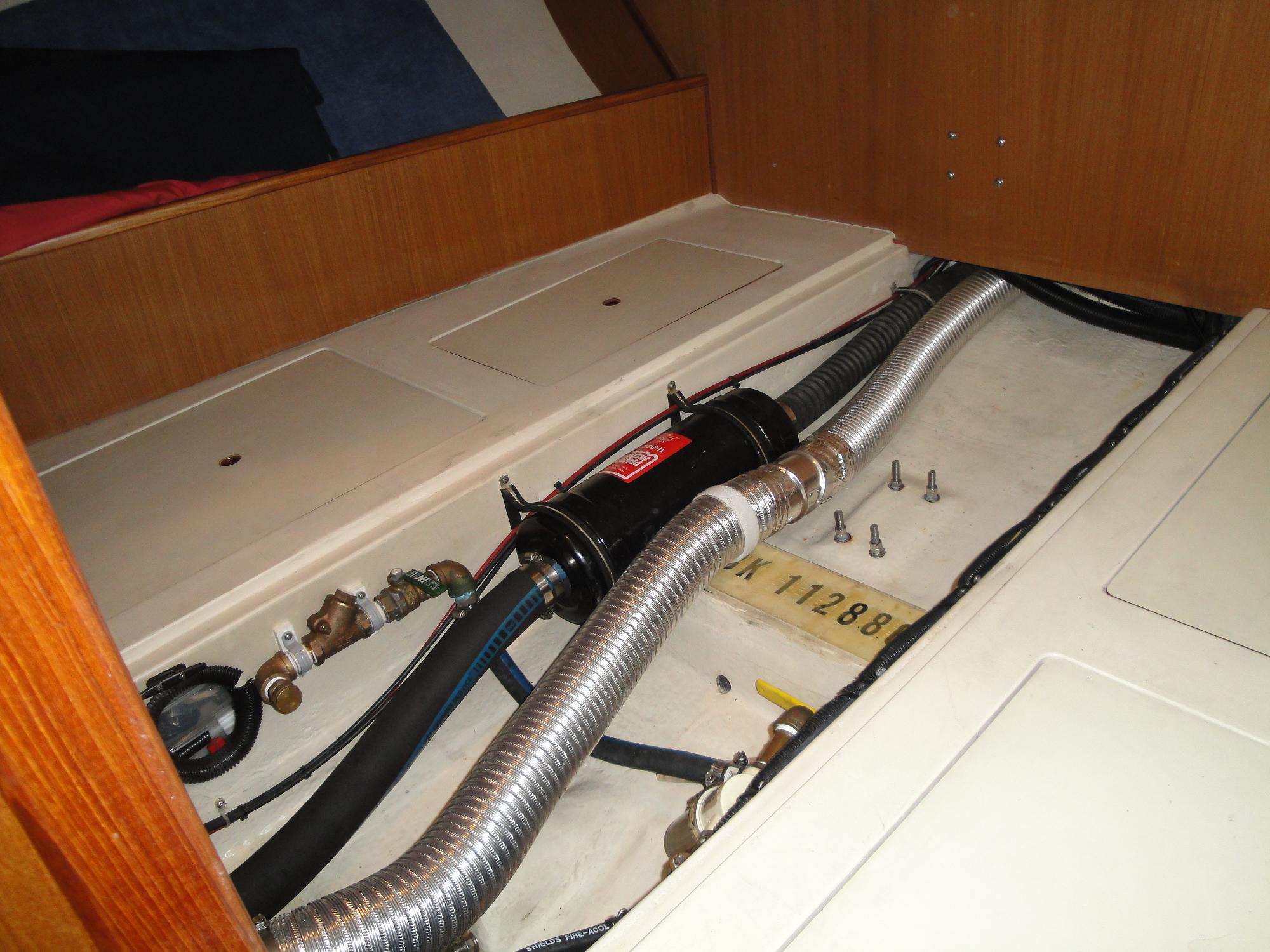

I switched from a Yellow Tail Blower to a Detmar blower after about 10 minutes of running. The Yellow Tail blower was so noisy I cut the wires to it after only 10 minutes into an all day outing. The Detmar was quieter but still noisy for another reason :

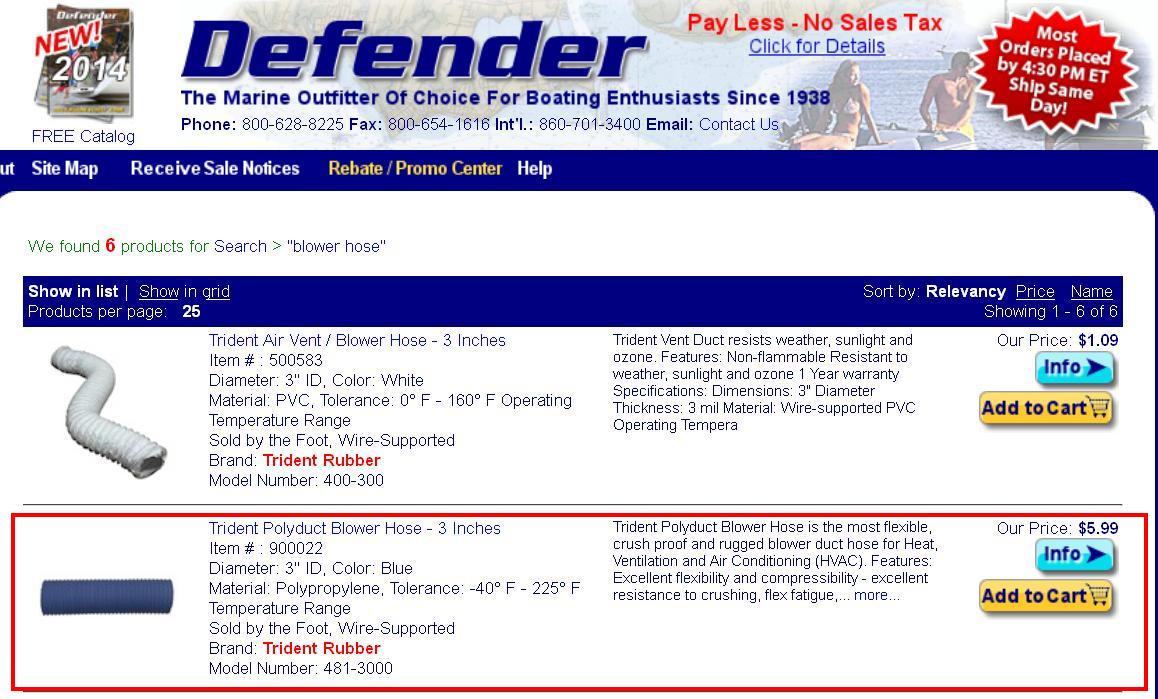

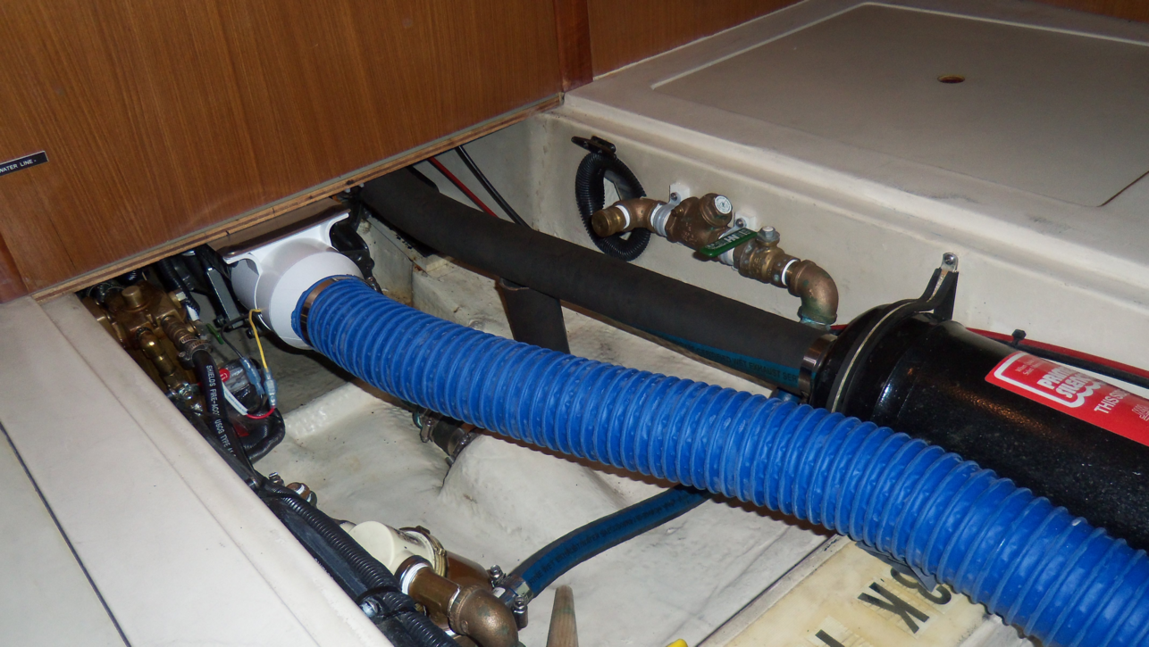

I had gone cheap and used aluminum dryer vent for the exhaust. It screamed like a banshee. A little more investigation and I installed :

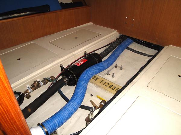

Trident Polypropylene Blower Hose. Much quieter and it's stayed that way since 2012. The hose inside the engine compartment is still aluminum for temperature resistance.
A little pricy even back then but well worth it.

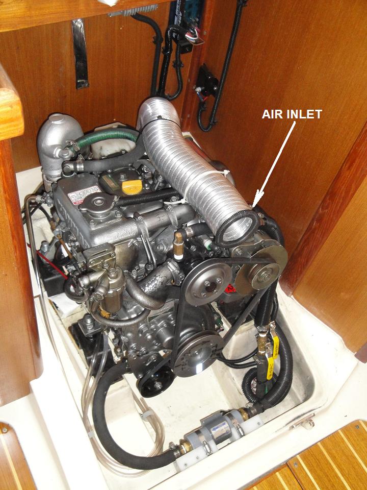

Directing cool air over the alternator will make the alternator happy, extend its life, and improve efficiency.
Saw this article on this very subject. You might find it helpful.

I did this with my bilge blower with the intake coming directly from the front of the alternator. It gave me a 50º drop in the alternator case temperature. I have a fully sound insulated engine compartment so without the fan, it gets very hot in the engine space and the 560Ah LFP bank makes the alternator work hard for a long time. I plan to rewire the power to the blower so that it comes on anytime the engine key is on and can also be turned on with a manual switch to provide post motoring cooling so that all of that heat doesn't just soak into the boat in summer.
