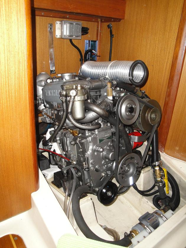

I'm starting to use mine. I never had a blower on our Starwind. The engine compartment was open to a lot of space under the cockpit. So I was not in the habit of running a blower as I was with my inboard gas engine ski boat before starting. I didn't even notice the blower switch on our Catalina for awhile. The compartment is fairly confined. I moved the regulator outside the compartment and I started using the blower and now leave it on for a while after shutting the engine down. I think it has made a positive difference.

When you install a "compartment suction fan" you are evacuating the air from the space.
Did you also install a vent to replace the air.
Your diesel can not run in a vacuum.
As mentioned in post #11, the air comes from the bilge area which is in communication with the most aft section of the boat which is wide open to air ingress.
Air can also be pulled from the forward section of the hull between the stringers.
