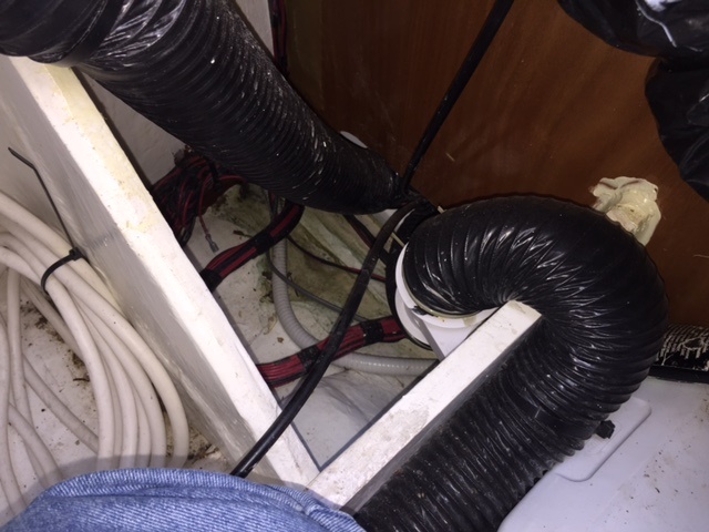

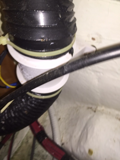

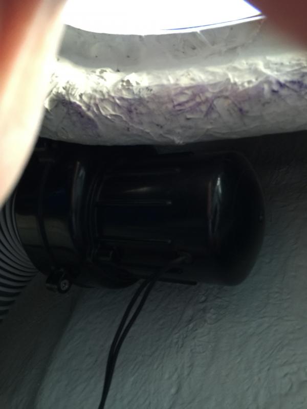

Again the blower is located in the aft starboard locker - you'll need to crawl into it to locate it.
Before you replace it I'm put a meter on it with the key on to see if you have power going into it. Mine (photo) is a replacement so it might differ slightly. Again this is a standard blower used in powerboats to ventilate engine compartments - shelf item.
a couple of photos attached.

Now that sounds strange! I expect you to have two hoses like in my boat. One to take fresh air into the engine area without anything connected to it and another one to bring the hot air out of the engine area. The last one should have been connected to a blower right at the end of the hose attached to some aft lazarette I would guess. The blower in my boat is a plastimo blower, part ref: 16274 (http://www.plastimo.com/en/ventilateur-de-cale-classique-9710.html) just to get an idea how it looks like.
Edit: I have realised that I have a picture of it. Oh, by the way it was a bit tricky to find it. You really need to search inside the lazarette to spot it!

Yes there are two hose just as you say. I haven't seen anything like what you show in the pic.
It must be tucked away enough where I completely missed it.
I'll look again tomorrow.
