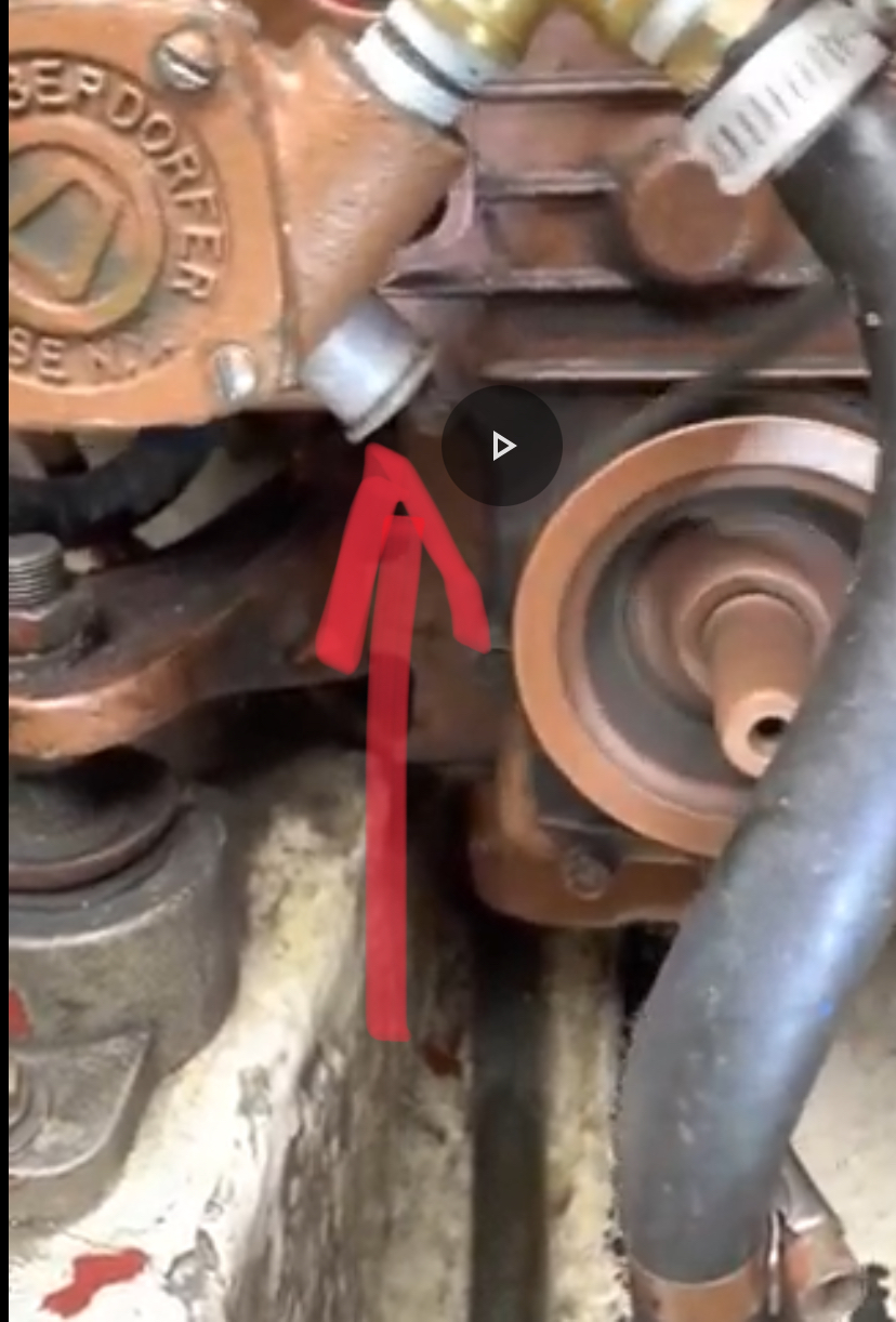

1) Has the engine belt too much slack?
2) a drop of clear liquid (greasy water at touch) falls every 45 sec or so
thx!!!
capta
Jun 4, 2009
5,069
You are right, too much slack in the belt. The leak is the seal in the pump and there may be a kit to replace it. The belt may have been over tightened, causing the seal leak and that could have caused the slack belt now. I would buy a replacement pump, fixing this one as a spare, but sometimes the seal seat is too worn and the kit won't help.

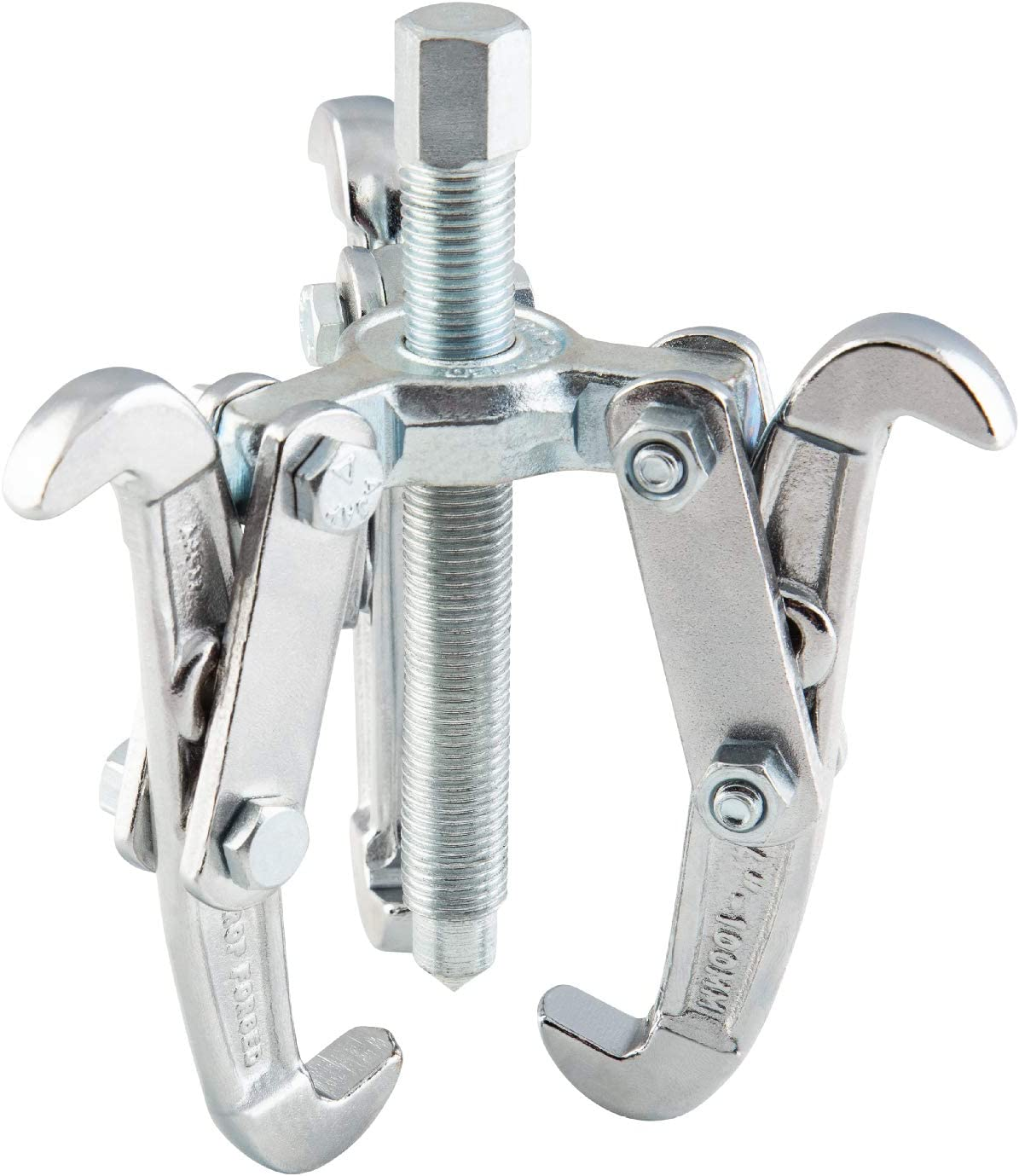

And here is the instructions
The steering wheel puller is available at autostore for a reasonable price, $ 13.00. I originally bought it to remove the boat steering wheel. With this device you can precisely insert the seals. Removing is very easy.
