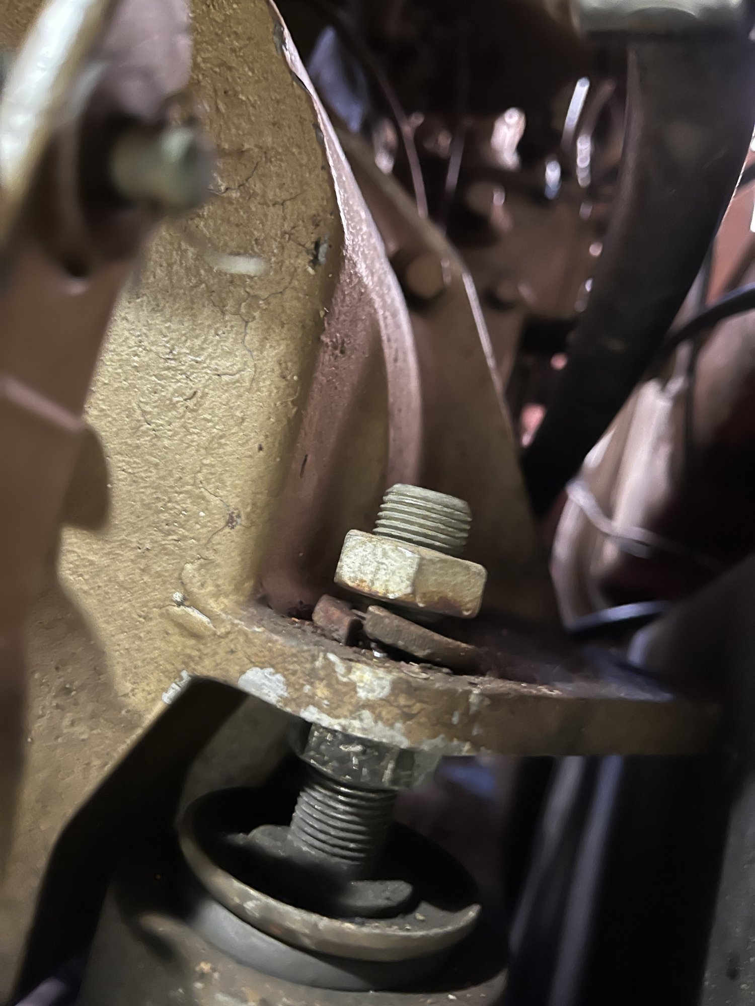

When replacing my stuffing box, I find that the shaft coupling is higher than the transmission output bracket. I believe the shaft is where it wants to be (is straight and aligned by the cutlass bearing and stuffing box which is on a super rigid thick hose). So I am planning to raise up the engine. I am guessing about 1/8 inch or so.
I read some forum threads talking about adding wood, etc. I don't think I want to go there. Maybe on my next haul out, I might replace the mounts or some other more drastic upgrade.
My main question is adjustment consists of loosening the top nut, and turning the bottom nut to raise or lower. Correct?
Correct. You might need to adjust front and rear engine mounts. Use a feeler gauge all around the circumference of the interface between the coupling and the transmission output plate. You are looking for no more than .002“ difference between positions at 180-degrees from each other all-around. As noted in other posts, final alignment must be done in the water.

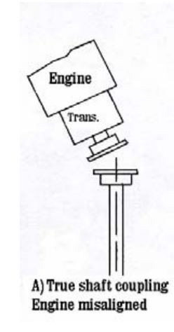

As outlined in the instructions on alignment (post #8), the alignment you are looking for (and most difficult to achieve) is the angular alignment :
This is assuming both flanges are true to their their respective shafts. The instruction manual will take you through proving if the flanges are true.
Taking a wild guess here, I'm going to guess the drop in your engine height is due to the rubber in your mounts losing some of their elasticity due to age. Unfortunately, we all know what that means and it ain't pretty.

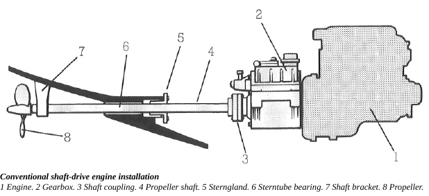

Ok so this is a topic and a task I haven’t done personally. Last boat after I changed mounts had a mechanic do it. New boat appears fine with no abnormal wear on the cutlass or vibrations and mounts are still good. So my question…… I know it is best to do the alignment when boat is in the water and hull shape is settled, however, how do you know when the shaft is perfectly inside the cutlass when you can’t see it? Is it a zen feel of the shaft you get from experience?

.....AND, additionally, how can you tell when the shaft is straight in the stuffing box if it sags under its own weight?
It matters not whether the stuffing box or the cutless are straight. They have some degree if slop built in (if properly sized) and will wear into alignment if slightly off. When aligning the engine to the shaft (the focus of the thread) You need to be concerned with only 3 elements:
1) shaft is straight within acceptable runout limits (.005”)
2) coupling is properly faced (.002”)
3) transmission plate alignment to coupling face is within .002”.
# 1 and #2 are measured off the boat at a machine shop. Any prop and shaft service facility does this every day, and your local boatyards know where to send it. #3 is the subject of this thread. If any one of these things is out of true it will result in excessive vibration.
