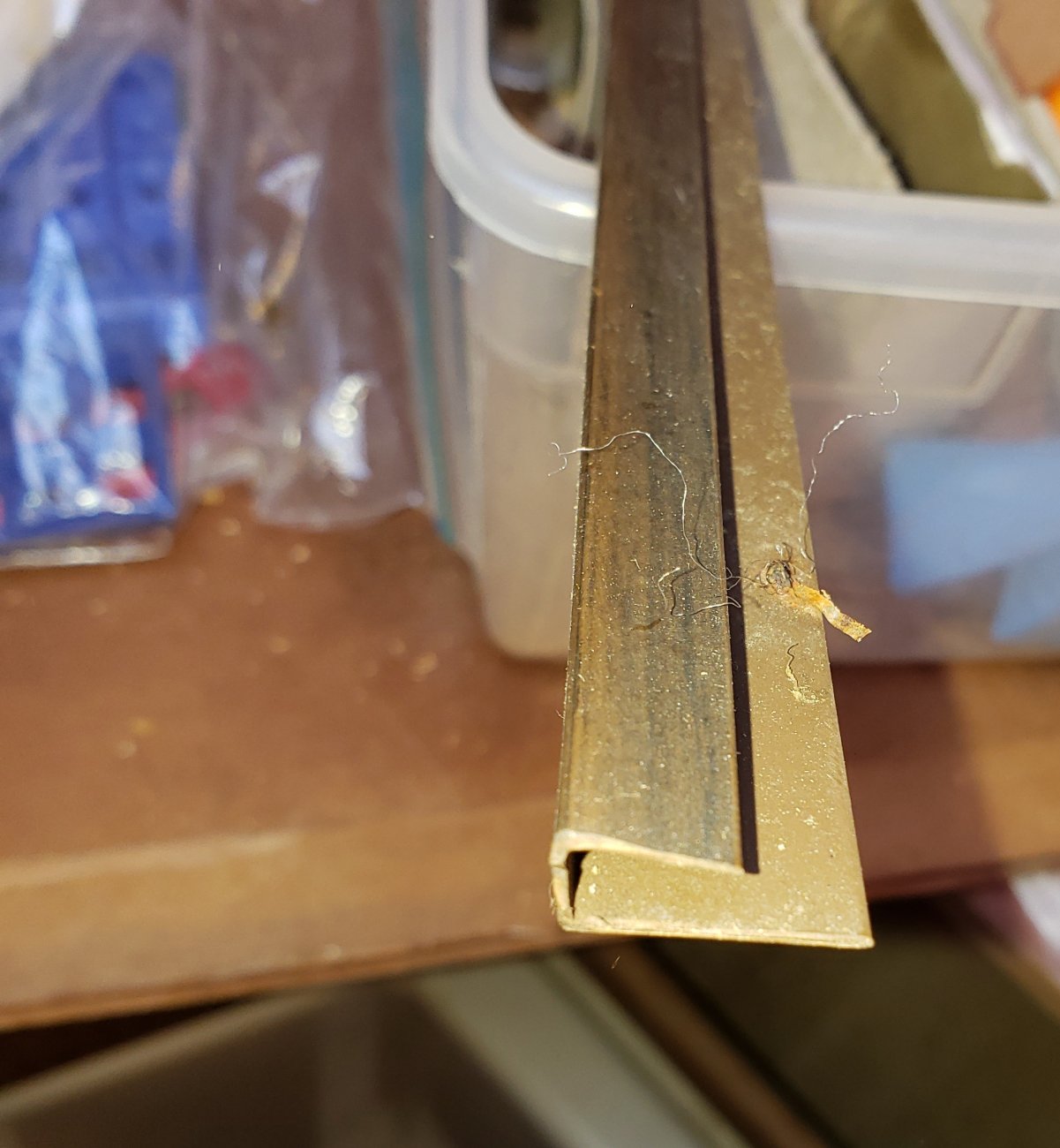

I'm replacing the hull blankets on my 1984 H34 and would like to get the plastic end pieces(?) that provide a nice stopping point for the blanket. Below is a picture. Any thoughts?
347
Hunter 34 Herrington South, MD
THANKS so much!! I spent so much time, even on Amazon, but didn't know what to call it.

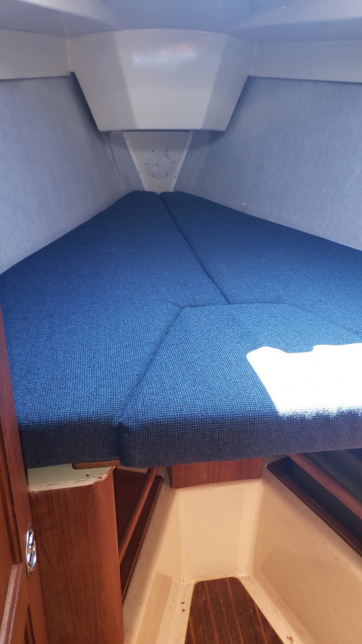

Don't worry about replacing the hull blankets. Just rip off the old blankets and replace with new from places like sailrite. I cut the material about 2 or 3 inches wider and then sprayed the hull with 3M adhesive. I think it was 77. I bought the "strong" 3M but it required spraying both sides and the hull only spray seemed to work fine.
Once in place i used a sharp knife/razor blade to cut off the excess.IMG-20190525-WA0000.jpeg IMG-20190525-WA0000.jpeg
