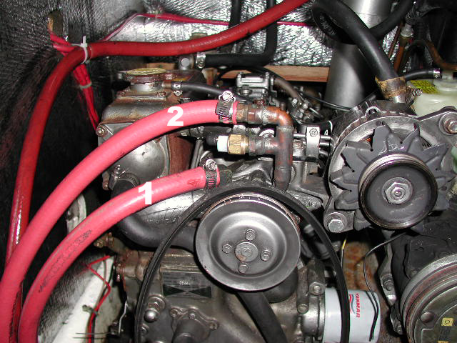

Ditto Skipper and Jackdaw. If you're still unsure, then disconnect the hoses at the engine and replace with a short length of hose thus eliminating the hot water tank circuit altogether. On my boat that would be hoses 1 & 2. Yours might be installed a little different. You will need to replenish coolant when reinstalling a new water heater as what is in the hoses now will be lost in the bilge !
