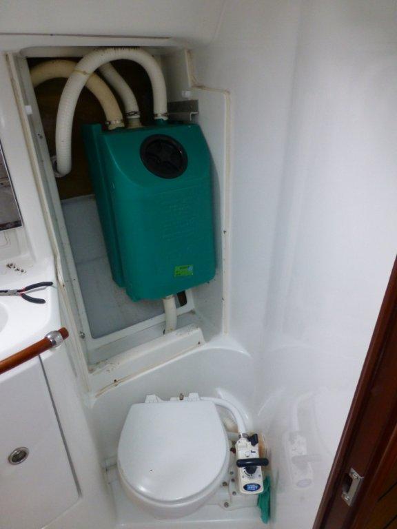

Most of the newer French boats I've been on use a small green 6 gal. (?) tank which is located behind the panel in back of the toilet. The tank is above the toilet and dumps by gravity, tank is connected by hose straight down to thru hull. Open valve, tank dumps, no pumps involved. Usually the intake valve is located beneath the sink.

There are 4 hoses connected to that tank...The one coming out of the bottom is obviously the one that goes to the thru-hull (which had better be below waterline!)...one of hoses on the top has to be the inlet from the toilet, and smaller diameter hose has to be the tank vent...but what's the 3rd one do?
Btw....a Jabsco toilet can move bowl contents up to 4 vertical feet, but the inlet on the tank looks a good bit higher than that...which I suspect presents interesting challenges for owners who have to use the tank.
