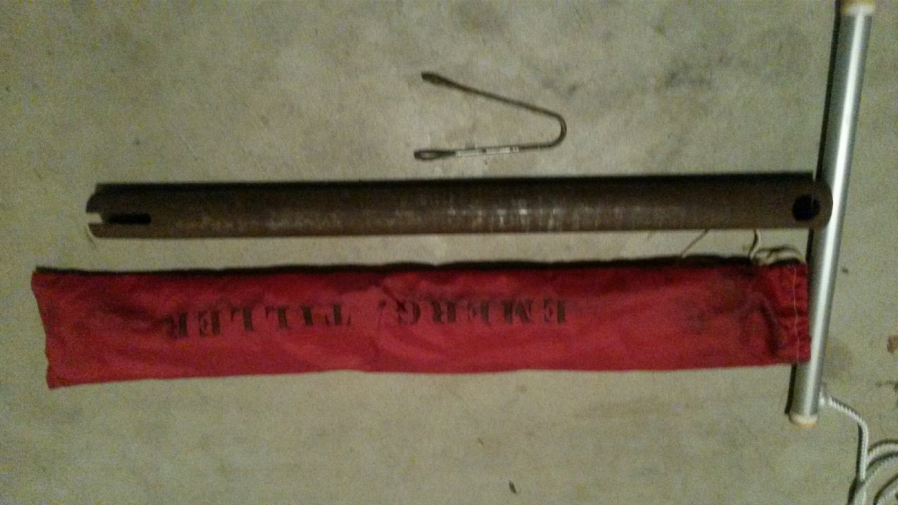

the emergency tiller, such as it is, consists of a hollow, metal tube with a hole near one end, and a solid rod that is put through said hole.
