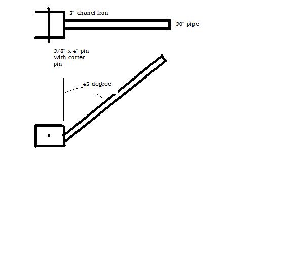

It turned out to be a failed tensioner, and all is well now. I smile as I remember how tiring that ride home was, and how fortunate we were with timing and weather, but take from my experience the serious note that an emergency tiller is a good idea. I believe it to be a requirement.
I’ll be fitting mine this weekend before we head back out.
