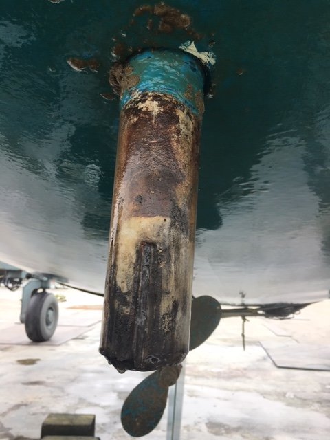

good post and as always great info shared. this topic is of special interest to me since I lost my rudder a few weeks back in a race in Galveston Bay. We were a few miles out into the bay near the shipping lane. Apparently we hit something or something hit us that broke the rudder completely off (pic attached of remaining stub). Weather conditions were breezy (~15 miles) with a chop/slop from an approaching cold front. I have TowBoat US so for bay sailing/racing , this was sufficient to get us back to the marina but like other posts above, I am concerned when I do go offshore Gulf of Mexico (cruise from Tx to Fla panhandle in the spring) and what would I do if this were to happen again.
Lessons learned from this recent experience is to have some sort of drogue onboard. While under tow, the boat was swinging wildly. To mitigate this, we towed a 5 gal bucket from about 30 feet from the stern. this did help somewhat but a proper drogue would have been safer. I've read the posts above and agree that a drogue such as a Gale Rider (got kudos from Practical Sailor) is a benefit to have onboard if offshore sailing and I do plan to invest in one as part of my safetey gear for offshore.
