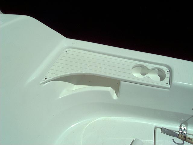

Might have found a place for those elusive leaks that some of us are having. I'm Still preparing the boat, can't believe I'm not in the water YET!!! My wife is about ready to beat me up. I digress....Checking the cup holders in the port and starboard sides, I removed them to clean under the edges. Stuff was growing under there very green reaching out for me. Well I found 1 out 4 screws on both sides had NO cauling. This would be a great place for a small leak to occur and drive you nuts trying to find it.Check yours....JimS/V JavaPicture of the affected area..
