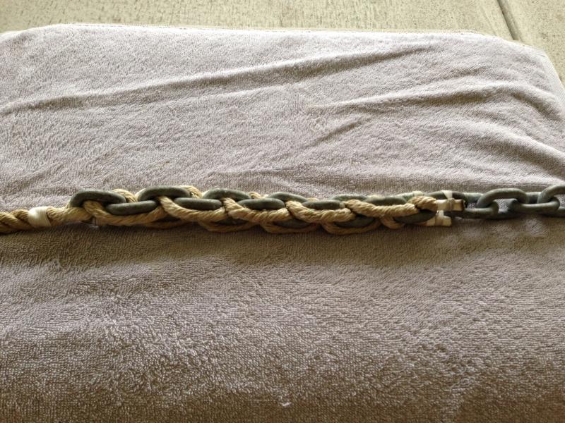

Went to anchor out a couple of weekends ago and found that the stainless steel thimble the line was spliced to was disintegrating. Not wanting to take any risks I pulled my spare anchor from the lazarette and found that it's thimble wasn't much better but usable. I've since bought 240' of new 9/16 3-strand and 30' of chain for my bow anchor which was old and crusty.
Rather than splice in a new thimble and re-rig the swivel and shackle from my old rig I decided to splice the line directly to the chain. Found many web sites showing the back splice where the three strands wrap around the end link and splice back onto the line itself and only three that showed the "elongated" splice where the strands are spliced through several links of chain.

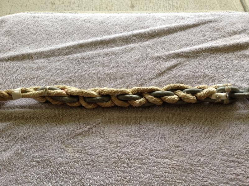

That's what I used. Attached are some pics of my splice. I don't have a windlass which is probably what the line to chain spices are meant for but I like the simplicity and lack of extraneous hardware.
Thoughts? Downsides?

Looks good! I did the same splice for my secondary, typically used as the stern anchor when both are down; however, I've also used it off the bow whenever I've wanted to take the heavy bower off (racing).
I have a (vertical) Sprint 1000 combination chain/nylon windlass; the splice needs help getting around the gypsy head b/c it jams (a little too thick). Holds fine when down; but the rope gets chaffed being so exposed, so you might have to redo every few dozen deployments. Can't win; it's one thing or the other. A 3-strand [eye] splice to the ultimate link of the chain is what my rigger normally puts in. It holds up better on chaffing; but it's also been redone a couple of times.
8,157
This subject has been beaten to death on this forum. Search "chain rope splice" and you should get multiple threads with a variety of opinions on this.
There is no right answer. You just need to read the various opinions and decide what risk you want to take.
