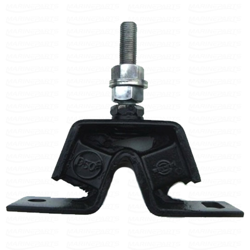

My 1985 O'day 28 was re-powered with a Yanmar 3GM30F. The engine has a DOM of 1994, so I'm thinking is was done in '94 or 95. It appears that the mounts are original so I have decided to replace them. OEM mounts are crazy expensive. Does anyone have any experience with Ellebogen mounts from Spain? Website is very good and I was able to download drawings of the replacement isolators I need. They are dimensionally identical to the OEM ones and have a good warranty.

Well, if you have ever had an engine mount fail in rough seas, as I have, planned maintenance would seem prudent. I don't know which type of Yanmar mounts the OP has but, on the 'inerted V' ones, the bond of the rubber blocks to the steel eventually fails.

"Age is just a number" is a faulty premise and in my experience in both the commercial and recreational marine world has lead to more than one catastrophic failure. Jim Legere makes an excellent point and mine are indeed the inverted "V" type.

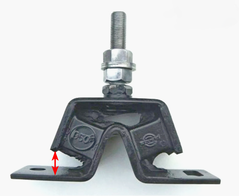

I remember running across an article that gave a minimum measurement for the clearance between the top and bottom steel parts, measured at the edges next to the bolts. Problem is I don't remember what that measurement was. :yikes:.. I would guess that the number is around 3/16" since that is about how much the engine moves at idle.

Yes, I remember that the it's the vertical clearance you want to keep an eye on :
Unfortunately, I didn't learn about this little edict until the engine was well along in years. And similar to you, I cannot find that minimum allowable clearance, or maximum allowable amount of drop anywhere. I still have a healthy clearance and no vibration of the boat anywhere at low RPM in neutral so I'm not interested in renewing even with 25 YO supports.

Thanks for all the great input. Had a great telcon w/ Aitor Ellebogen and will be going forward with the purchase. @Ralph Johnstone, I have measured the distance you referenced, and it is definitively below minimums.

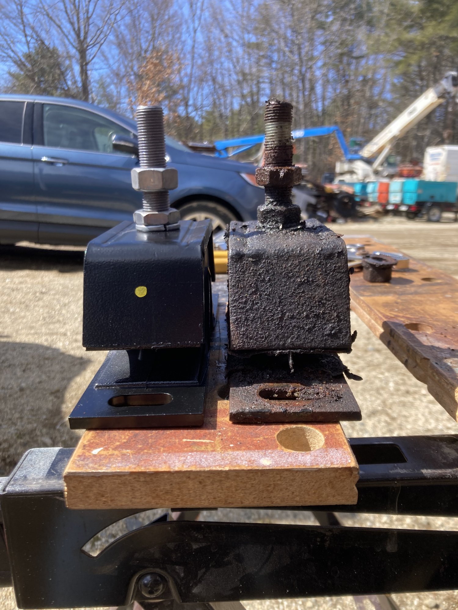

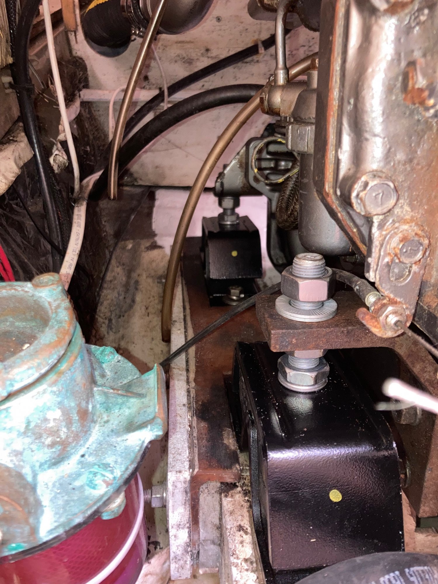

Update regarding my isolator replacement project. As mentioned before, Aitor Ellebogen was most helpful and I took advantage of a Black Friday (in Spain no less!!) deal and was able to get a set for just over $400 which included shipping.
I am really glad that I did not wait any longer. The attached images do not really convey how bad the originals were. The rubber is so weak that I could manually angle the stud 10-20 degrees on either side of the Y axis. If I clamped the base to the workbench, I could rotate the upper part of the mount 20+ degrees in either direction on the X axis using a crescent wrench on the lower nut. Most importantly, they were installed incorrectly. Specifically, the higher durometer scale rated isolators (in this case 100) should be installed forward, and the 75s should be aft. This is what the Ellebogen documentation calls out as well as my Yanmar GM Series technical manual. What I found were 100s aft and 75s forward. The new isolator studs will get a generous coating of Boeshield to keep them looking new and also to make alignment easier going forward.
