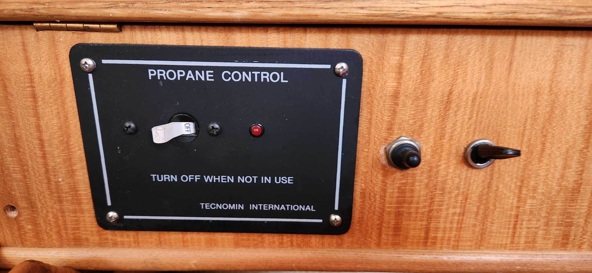

Under the panel, there are 2 switches, under the panel by about 2 inches on the wood. I dont know what these are and the old owner is not in a position to remember.
Anybody have a clue what they are for?

Your guess is as good as ours at this point - no telling what the previous owner installed. You will need to open the panel and trace the wires. Welcome to the forum! :beer:

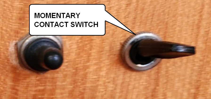

I'd guess they're something installed by the previous owner(s) because there's no label as to what they are. I'll take a mile wide guess and say the switch on the right is a momentary contact switch for testing the operation of the bilge pump.
If you don't have an electric bilge pump, scrap that idea.
Time to do some wire tracing on your part.

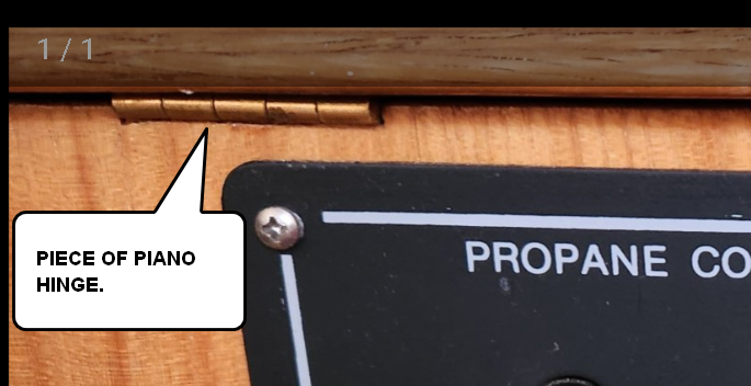

I see there's a short piece of piano hinge at the top of the wooden panel :
With a little bit of luck, you should be able to lift the panel and expose the wiring beneath. If you can't open the panel on the hinge, you will have to devise another way of getting back there.
Once the panel is open, trace the wires back to the two their respective loads and you'll see their funtions.

As others have said, that is most likely an addition by a previous owner and not factory installed. The factory would have used some kind of panel and label for the switches.
Are these 2 position switches (on-off), 3 position (on-off-on), or a momentary switch? Knowing this might start to limit the possibilities.

Thanks for your replies. Yes, the hinge does open the panel box. The one switch that you mentioned is a momentary switch, but not got the bilge. The vilgevhas it's own breaker on the panel box.
I was hoping that they are standard switches and someone has this.
I guess I will have to try to trace as you suggested.

It has been opened when we did the survey, so I know I can get back there.

As far as the "momentary switch" is concerned. I'd get a buddy or two on the boat with me. Open as many hatches, doors and openings as you can. Then momentarily flip the switch to the on position. If it has more than one position try both and have the buddy stick his/her head in the openings and listen for something to start. I can't think of many loads other than a pump that would have a momentary switch. If nothing heard, move to the next opening and try again. You might get lucky. While you do all this, look at your DC amp meter and see if there is indication of a load when you hit the switch. Most things will show some load increase when you flip the switch. From the size of the load you might get an indication of the nature of the switch.
Same procedure actually holds for the other switch too. As far as sound though, the load might not make a sound if it is something like a light but it still should show a load. I have added a couple switch myself but I did label them. One is for a fuel polishing system and one is for an exhaust fan for the engine compartment pulling air from near the alternator. You can hear both easily.
Think out of the box and you might get lucky.
