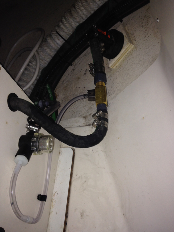

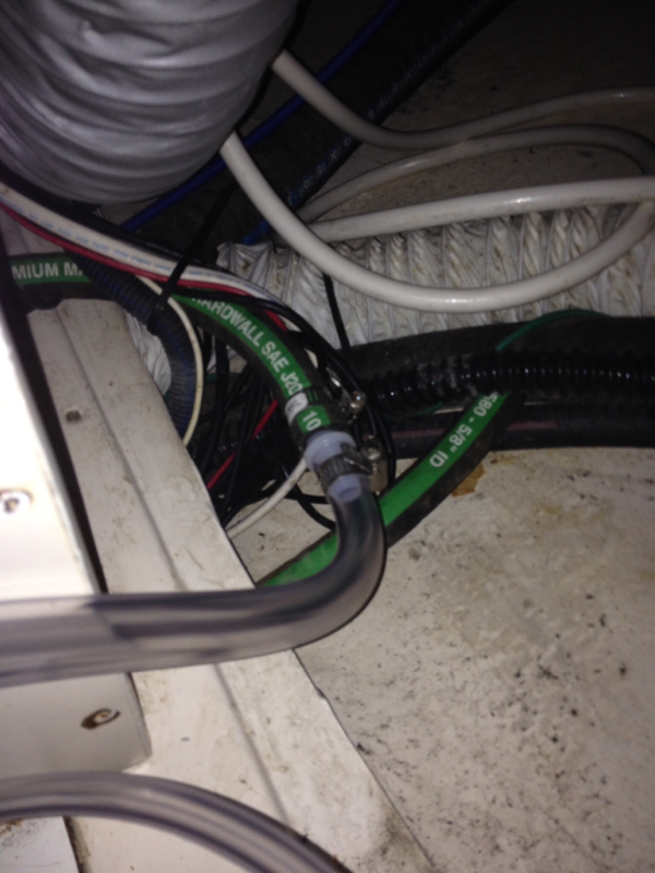

I hate to see water always standing in my 309 bilge. Mainly from the AC condensate, but also when using the ice box. I recently solved the main problem, the AC condensate by installing a Mermaid " Condensator" . It uses a simple ( not cheap) Venturi in the AC cooling/ heating raw water to siphon the condensate overboard with the raw water. No need to open the AC box (wasted 2 hours). Install the Venturi in the outlet hose on the port side near the thru hull. Cut the hose draining the condensate to the bilge, just aft of the AC unit at the bottom and hook the supplied clear line with a hose adapter ( mine was a different size) from Home Depoit. I added hose clamps on the suction hoses. Note the outlet water is now foamy because it sucks in air when there is no condensate.
