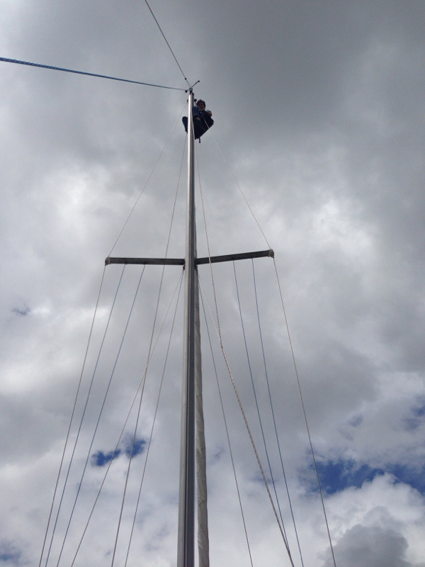

I sent my dear wife up the mast to replace the wind instrument. I understand your frustration, but if you can do these tasks yourself you will save big.
I agree the instrument should have been tested before being installed.

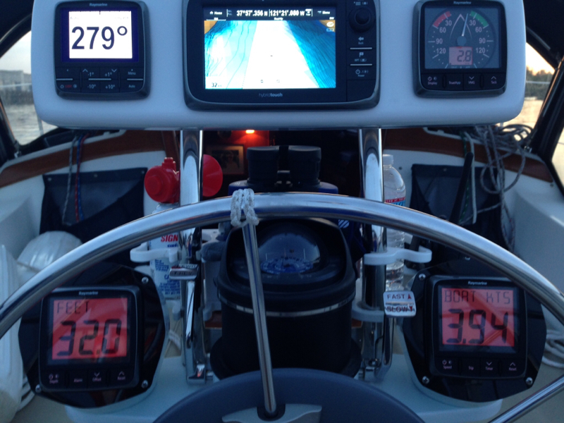

Recently installed all new Raymarine electonics E7 MFD, Radar, Autopilot, depth, wind & speed. Raymarine was very good in working with me, they have an excellent website....
