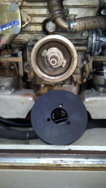

Well, we took the next step forward and ordered the serpentine belt kit for the Universal M-25 from Electromaax. Wouldn't you know it...it did not directly fit our crankshaft pulley (ours is not tapped to bolt the new pulley on it). So after discussing options with EM, I sent them my crank pulley and they are going to mold/mill a replacement pulley. Once I get it back and installed, I will post the results.
John at EM said they will set up a mold to make additional ones as people need it, so if you are contemplating the upgrade, give them a call. I have attached a picture or our crank pulley and the original "replacement" pulley.
Lastly, if you do go to remove the pulley, the retaining nut requires a 29MM axle socket. My dewalt rechargable impact wrench made quick work of removing the nut without damaging the shaft, or my knuckles.

Part of the problem E-Maax faces with the M-25 series is that it changed two or three times over the years.
I suspect the kit you have would fit an M-25 XPB but not an M-25 or M-25XP.... The M-25 XPB has three bolt holes in the crank pulley but the others don't..

It is the plain old M-25 (1986 vintage). I have been impressed wtih E-Maax so far. They are hoping to get the replacement pulley out to me in the next week. The water pump pulley and alternator (on a balmar 912) pulley fit perfectly.

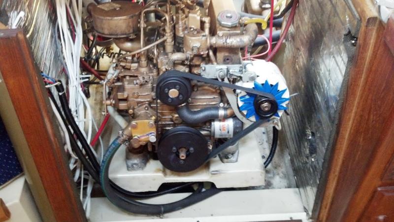

DONE!
We are up and running. Only 3 minor issues throughout, and Emaax worked hard to get things done. First, I needed to change the original crankshaft pulley for one that is tapped to receive their cover pulley. Secondly, the crankshaft on older m25s accepts a .875 bored hole. The pulley received was bored to .870, so a quick trip to the machine shop fixed that issue. Then, we had to re-measure the belt. The stock alternator bracket will accept a 42 inch (420) belt, but the updated bracket (hangs the alternator with the tension arm below) takes a 40 inch (400) belt. So now that we have sent the specs to emaax they should be ready and able to build a kit.
