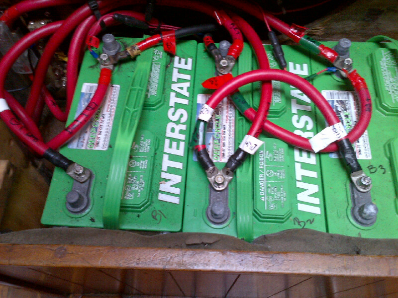

I'm surprised there is no electrical systems forum, so I'll post here.
I have 2 battery banks. One starter battery (Battery 1) and Two house batteries (Battery 2 and 3). My battery selector has Battery 1 (1), both (1,2,3) and Battery 2 (2 and 3 in parallel).
They are all Interstate SRM 27/12 Volt Deep Cycle Marine Batteries
Cranking amps 750
cold cranking amps 600
I bought the boat about 2 years ago and the prior owner indicated that the batteries shold be about about 3 years old to this date.
I keep them charged at the dock, connected to 120 v AC.
The last few times I've gone boating, after shutting off the engine, with the batteries set to house, I've lost electrical power after only about 30 min. The voltage is fine when the engine is running, for all 3 batteries.
I checked the specific gravity today and the two house batteries (Battery 2) seem to have a lower SG than the starter batteries.
Here are the SGs corrected for temperature for the 18 cells
1 2 3
1252 1266 1266
1307 1267 1267
1292 1267 1269
1297 1268 1218
1282 1267 1142
1297 1267 1267
It would appear that I have one bad and two marginal cells in Battery 3.
Questions.
Why would the 2 house batteries have lower capacity than the starter?
Is it unusual to have batteries like this, lose their life after 3 years? (I disconnected the batteries over the winter, but did not have them on trickle charge)
Is it time to replace all 3 and if so, I'd be interested in pros and cons. I have a battery box that just fits these 3, each measuring 12.75 X 6.75 inches.
re: relays and monitors
I have a macromatic voltage monitor relay and Xantrex Link 20
Thanks so much.
