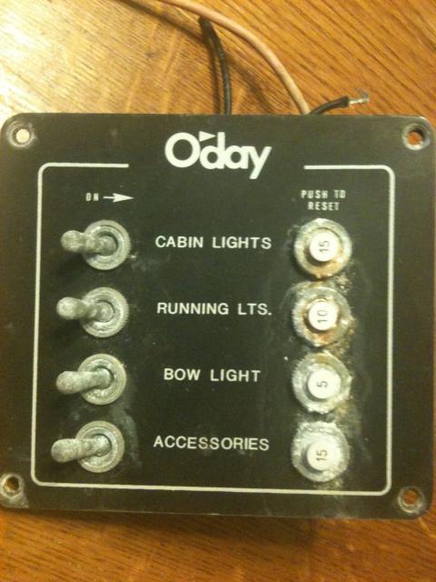

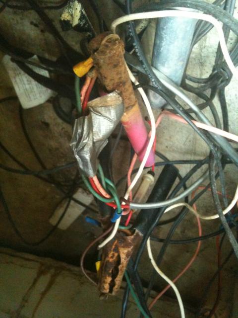

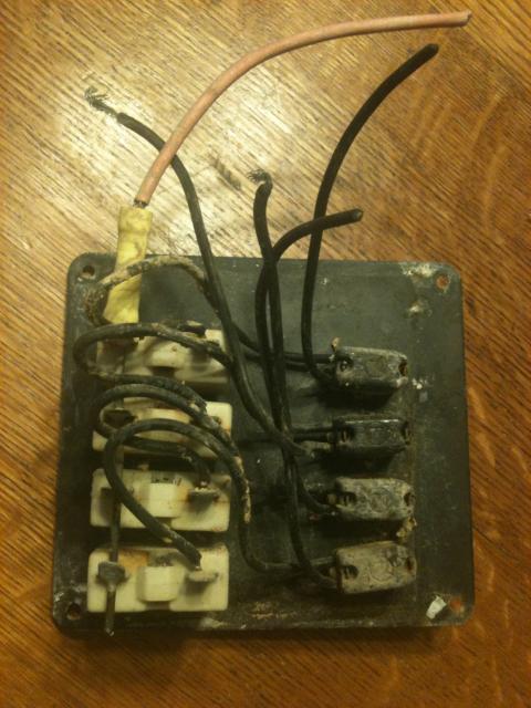

Attached are three pics of the electrical "system" on my boat as I found it shortly after acquiring the boat.
So far I've been just cleaning and making other repairs. It's time to tackle this project but I don't have much experience with the "sparky stuff."
Where do I start? Are there some particular threads here that you'd recommend? Thanks for any pointers!

That is a fire waiting to happen. Make sure you buy all the supplies you need in advance in bulk - and as suggested above, get a good book and do your research on how to do this. Its not very difficult - just make sure you have the right tools, supplies and knowledge.

love the ingenuity!
It looks like they salvaged the ends from an old battery charger as part of the wiring system. Classy! There have been a lot of boat wiring items at auction on Liquidation.com the spools they're selling are far longer than most would need but it may be cheaper to buy "Bulk" than picking up specified lengths. I think I'd start over if I were you.​

And this site's store has the wire and other components you will need. If the condition of the components shown in your pictures is any indication, all the wire itself and its connections at the various light fittings, etc., are likely to be in bad shape. All should be replaced.

There is not much left thats really worth using BUT its a small system so the cost should be on the low side
If you have shorepower ? it raises the cost and the need for a greater level of expert skill
From i what i see its best to make a wire ball and start over

That looks like a lot of corrosion! It is hard to imagine letting an electical panel get in such lousy shape. The good news is that this is your opportunity! I bought a book from this site called Boat Electrics Simplified (or something like that). The author is Casey(?) ... in any case it is a fairly thin book written in a style that you can easily understand. I found it to be a great guideline for remediating a simple electrical system.
