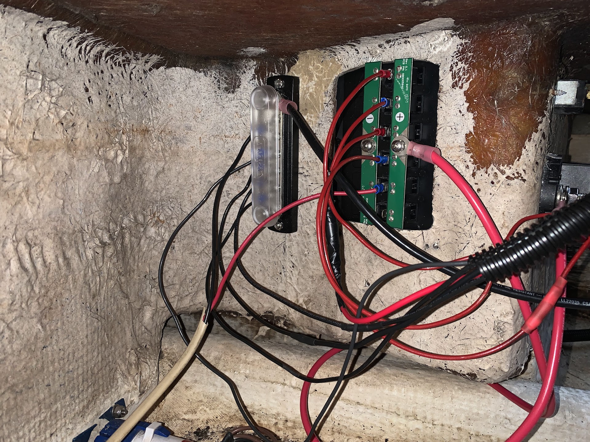

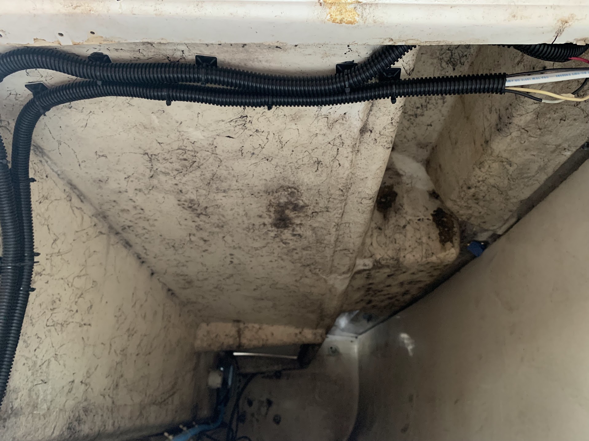

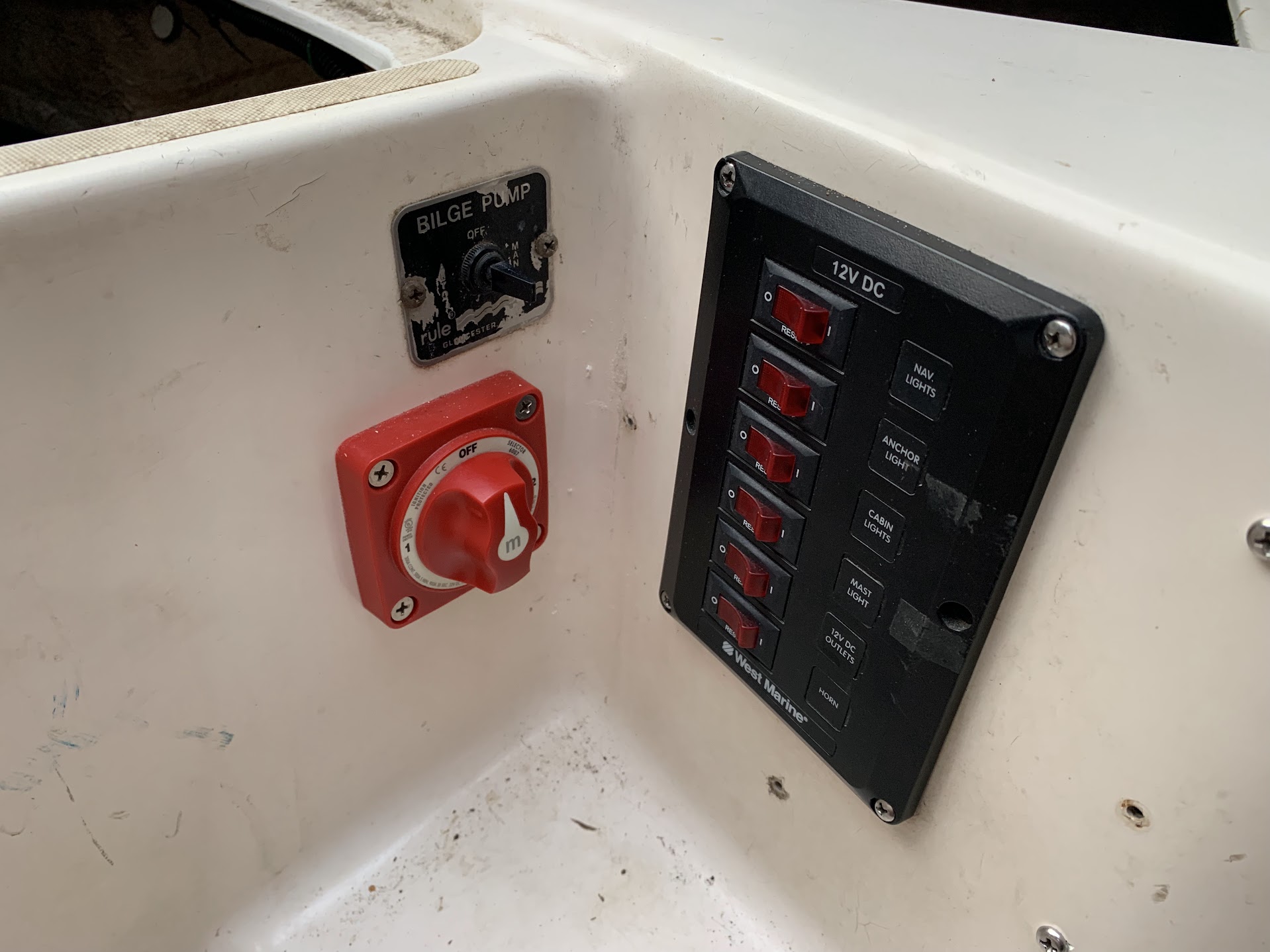

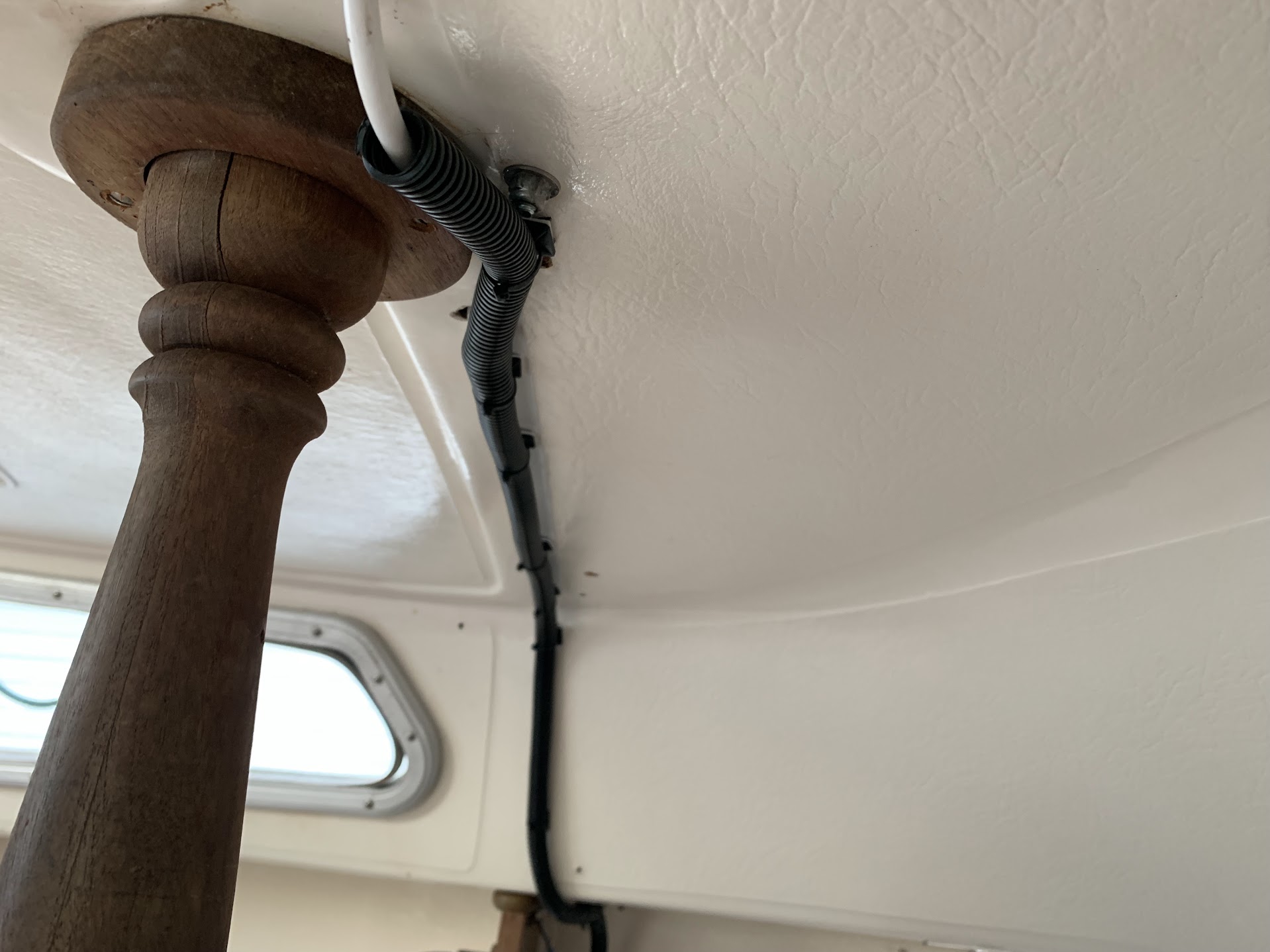

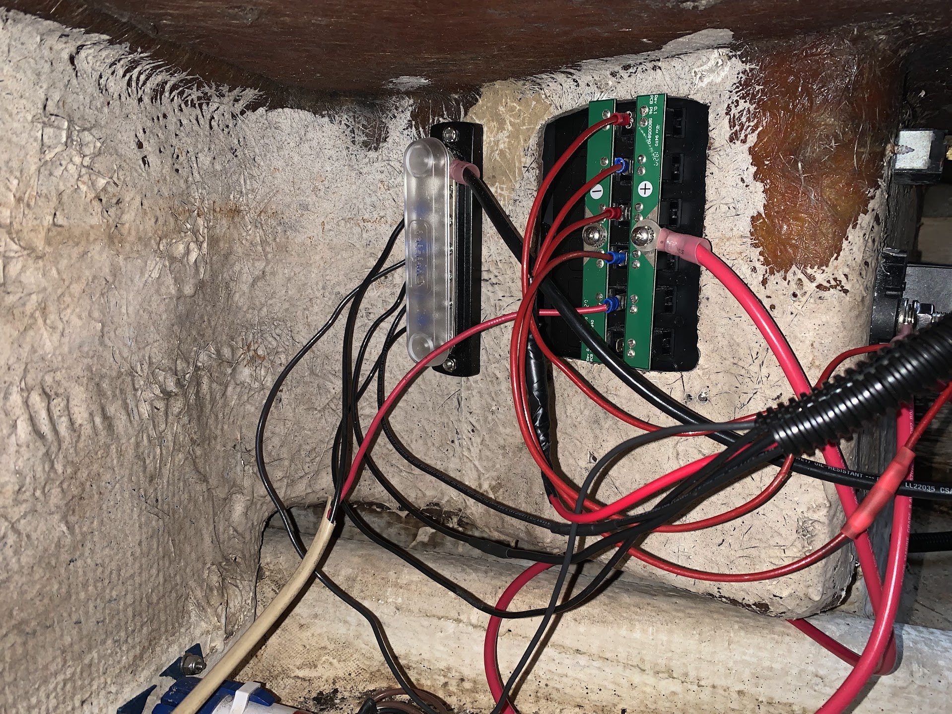

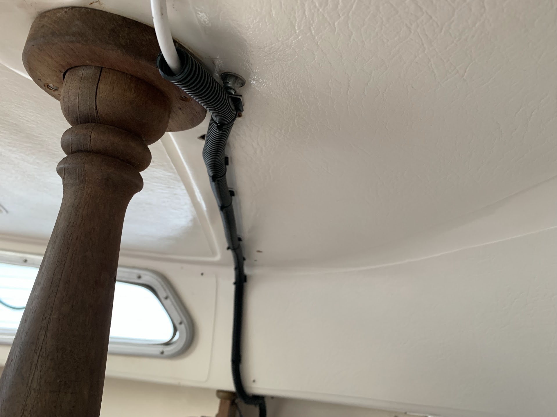

Spend the last two weekends (And two cases of beer) redoing the electrical on my Cat 22. I wish I had taken before pictures, because it was an absolute mess. The previous owners did whatever worked and it made no sense. I rerouted all the wires through split loom conduit. Rewired the masthead light with a new deck fitting. The battery was in the port aft lazarette, and I moved it to under the keel winch and reinstalled a new battery switch. Routed all positives to the switch panel and negatives to a bus bar. Pretty satisfied with the results. Lot's of work left to do but progress is progress!

Beer and wiring? A great pairing! Wiring requires crawling in and out of small spaces, being in distressed positions and a good deal of sweat. Beer is the perfect anodyne for all that. :beer:
Looks good, the hard part is done. Now all you need is a few cable ties to tidy things up and some label tags for the wires to make future troubleshooting more convenient for you or the next owner. Good job.

My only suggestion is to neaten things up and provide support so that wires aren't hanging out in places where stuff can grab onto them.
