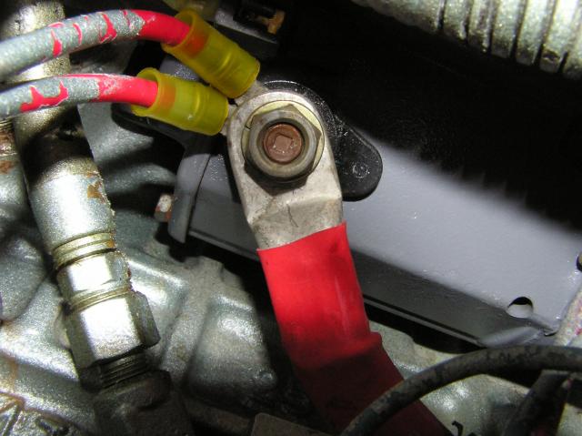

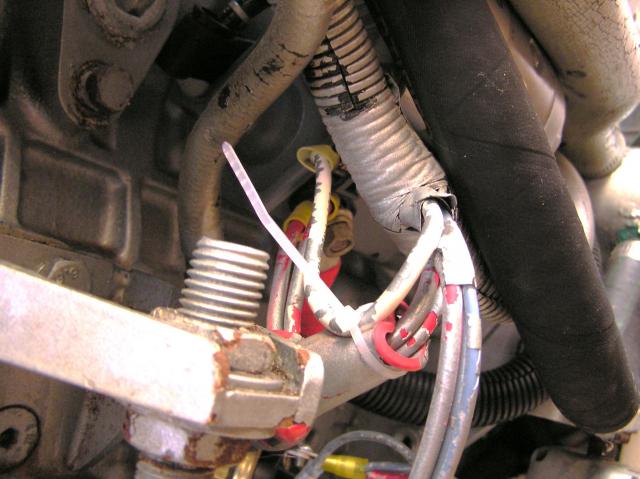

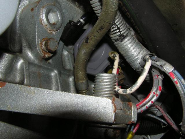

We are back from our San Juan trip, and the problem never recurred since I tightened all the connections. HOWEVER -
The first morning in Ludlow, we needed to be up and gone early to make the outgoing tide, and I went to start the engine and NOTHING! Thinking it might be the one place I hadn't looked, and that it might be related to THIS problem, I proceeded to take the gage pod apart (on the pedestal). Once opened, it was clear the connections were clean and tight, but I built a little test harness with a bulb and alligator clip wire to make sure 12V was getting out of the start and key switches (it was). SO - has to be either the starter or the solenoid (OH Joy, where to get parts on a Sunday...).
I pulled the engine hatch off and moved it forward, and proceeded to tighten all the connections, and ... WHERE the heck is the starter??? Looked and looked, and finally found it - PORT side under all the hoses and wires. HMMM - LOOK AT THAT!
The spade connector wire that plugs into the starter was off and just hanging there. Plugged it in, and pushed the starter button... VROOOM!
We lost an hour and a half, but we were finally off. The tides sucked a little going through the Pt Hudson area, but not terribly.
HOWEVER - In Garrison bay later in the week, the same thing happened, with the same problem - wire fell off. This time, I pinched the spade connector AND zip-tied the whole thing so it COULDN'T fall off. No problems the rest of the week.
Hopefully this will help someone else if they experience the same situation.
I DO wonder if this is related to the original problem??? If so, it is fixed.

Starter Connection
Doesn't the connection on the starter connect the output from the alternator to the battery. Was that the connector that was loose. That will definitely give you an indication of low voltage (e.g. 12vdc when you are expecting 13.5vdc from the alternator).
