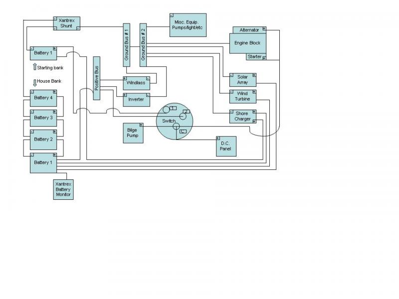

After making the battery compartment flooring repairs that I found were needed I then did the rewiring previously discussed to bring our installation more in line with traditional recommendations for wiring of marine 12V DC systems. Thanks to all who helped previously with their feedback. In addition to doing this to eliminate possible unknown issues this hopefully would give me a good starting point to diagnosis for ground faults/stray voltage etc..
When I completed the wiring (see attached diagram of completed work) I began to test for ground leaks. First I disconnected the shore power cable from the boat. Secondly I disconnected all electrical equipment bypassing the DC panel that was wired to the batteries directly (stereo always hot/on lead, auto bilge pump, battery monitor, etc... I Then removed the positive battery clamp and placed a voltmeter between the post and the clamp for the house bank and then later for the starting bank. The result in both cases was voltage ranging up to 5 volts.
