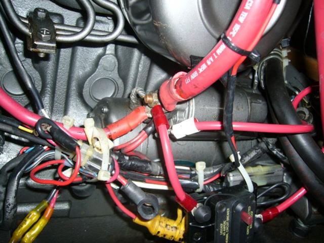

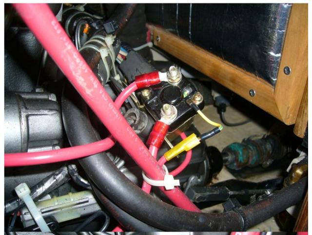

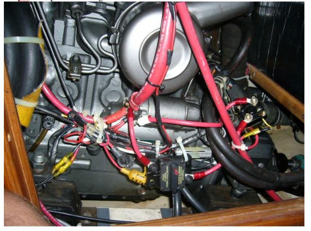

Here is Ed's solution (thank you again). I ran a no.8 marine grade wire from the starte button to my solenoid. I left the old bundle in place just in case. The number of shunts is the culprit. Not your contacts, not your ground most likely but not always. I got the solenoid from a marine parts dealer but I suppose you could use autozone. The pics are pretty self explanatory.
It starts, starts. I have started the motor after 8 hours of sailiing ON my house bank! This is your fix. Under 80 bucks easy.
Hope this helps
