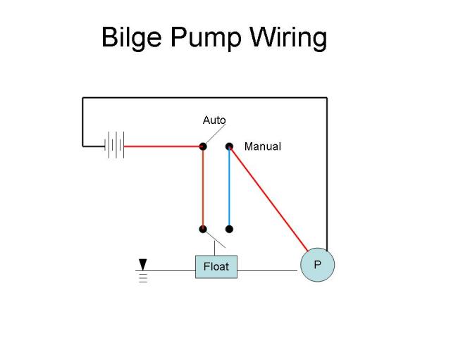

My wiring
Here is how mine is wired.
The thick lines are wires and the auto/manual is a switch
