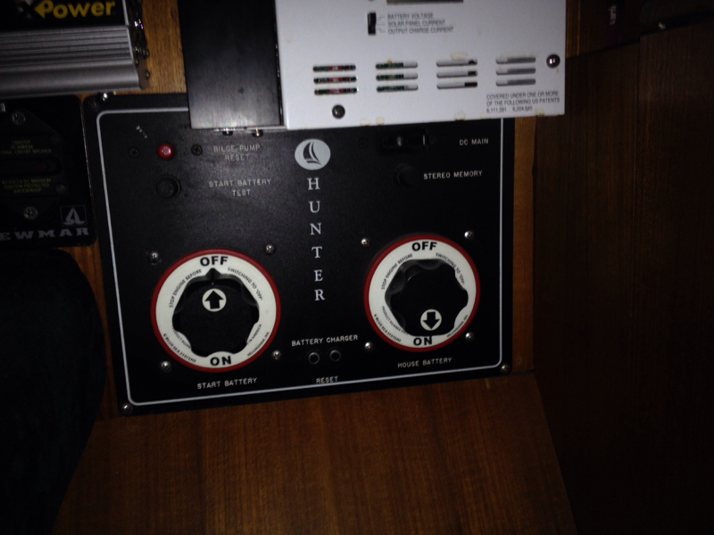

I need help... As a naval Architect, electrical issues are a mystery to me. I am a new Hunter 37C owner (1981 model) and very happy about our boat except that she fails to start after we have been sailing for several hours. I have replaced the batteries (3) and have one set up as a start and two as house batteries. Last time out the engine would not start on one, but did turn over and start on two. This week I left the boat off shore power and tried to start it - nothing. No alarms, no noise, nothing. I successfully and easily started the Yanmar diesel by jumping across the poles of the solenoid. Now all alarms function and it starts. I am baffled. I have checked switches, connections, fuses and wires. So smart Hunter owners, anyone have similar problems or anyone have a suggested solution???

I had a similar problem with my boat, I had sprayed some innox around the key switch and it would take lots of switches on and off before it would start so I sprayed it with electrical switch cleaner and fixed it. I also had the relay between the house & starter batteries start to work after a very rough trip down the coast. It hadn't worked since I bought my boat a year earlier meaning it didn't mater if the starter battery was switched on or off the boat started. I still always switched it off over night when anchored but this morning forgot to switch it on and it wouldn't start. So after starting it by shorting it across the solenoid made it into the marina, got the electrician out to discover all I had to do was switch the starter battery on. It's been 6 months and it is still working. Boats!
