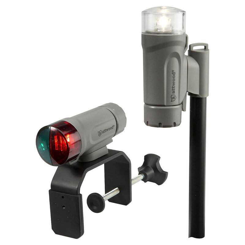

Alternatively... on a 19 foot boat what electrical do you really need? And how often do you sail or anchor out at night? You could just scrap the electric system and get some of these...
... for the occasion night sail

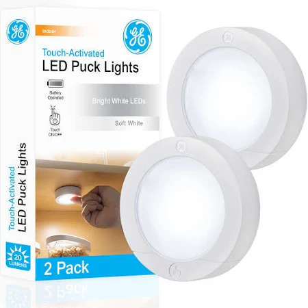

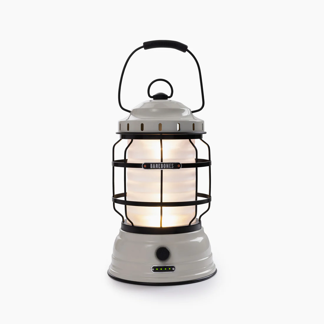

... and some of these to light the cabin when at anchor (at night)
and then an anchor light to hang on your boom...
You might want to keep your existing battery to run a bilge pump... but you could get a kayak hand bilge pump and just scrap the entire electric system all together... keep it all real simple and go sailing.:biggrin:

Thanks for the input. It was a new & fully charged 12v battery, voltage on the battery over 13v, terminals clean, connected to the system, but no voltage along the several circuits I tested, as far as I could reach them. Some of the wiring passes into channels and becomes difficult to reach, and some of the items it powers are sealed so could not test between, say the fuse clip and the item terminals. Yes, I could buy battery powered LED lights, but the 12v also powers a depth finder, as well as the cabin , bow, mast, and stern lights. Don't have big plans to go on trips where I would anchor overnight, but would like it all working so I could consider that in the future. And how many times do mariners misjudge how long they will be out or have some sort of breakdown and need those lights?
