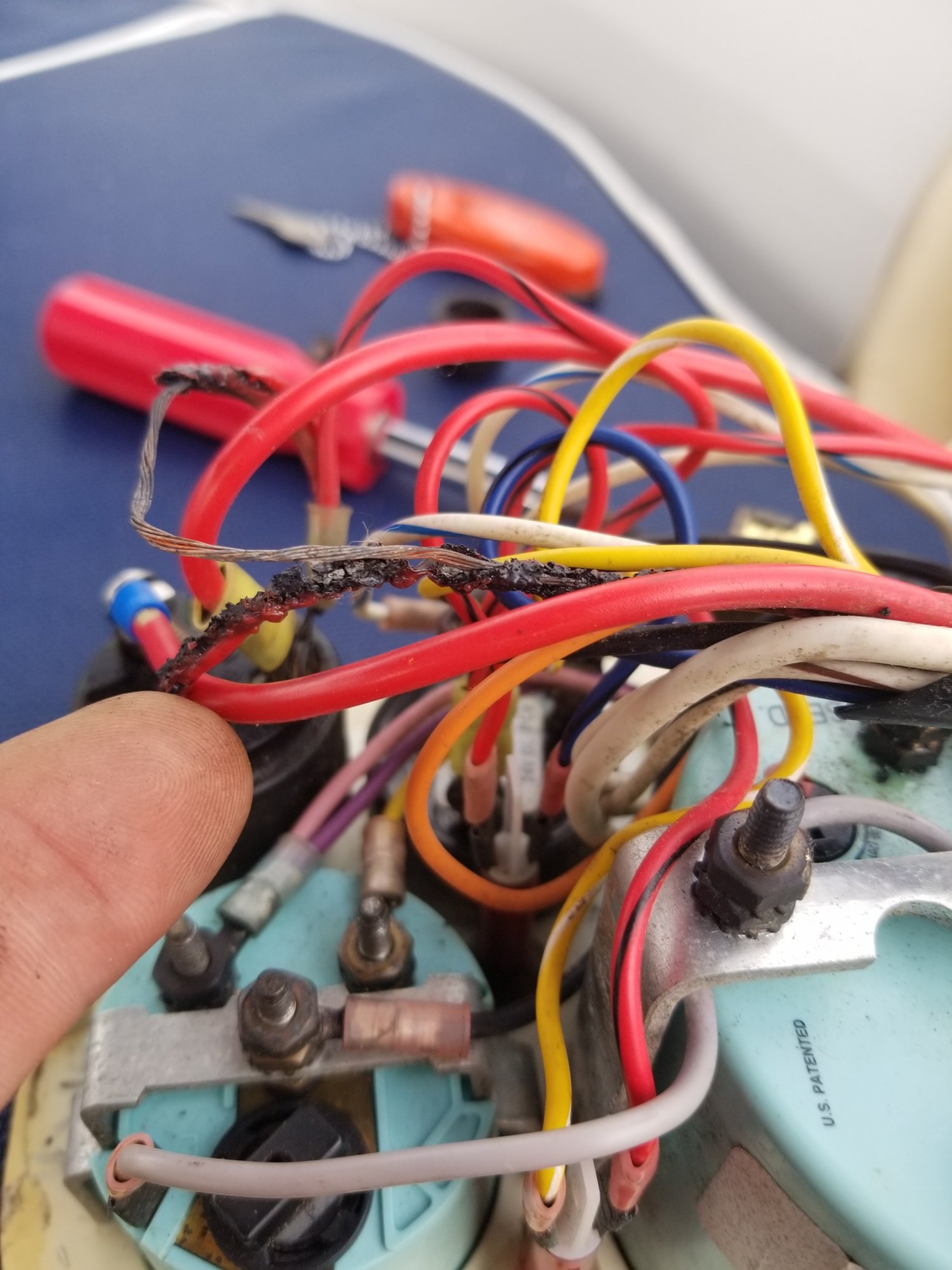

Had a high resistance ground, from ignition switch to Alternator controller, towed to Saint Augustine replaced switch and wire. But have to replace wiring, have a 1.5 v leakage in damage somewhere. Looking for good supplier for all the colors.

It looks like the wire is damaged into the wire bundle. I’d look at the bundle and the other end for wire condition that looks wrong. That will give you more info as to the issue.

Exactly what I did, there is melting all the way to the switch, and the Harbor Freight, connector to the Xanterx controller, which still works, whew! But have 1.5v leakage that sets off alarm when starting battery is switched on. BEFORE I turn on ignition. Not messing around building new. Looking for decent connectors and wire in right colors.

#1 Every wire on the vessel should be properly fused to prevent this. That level of insulation melting could have burned your boat to the waterline. If the boat had been correctly wired, to ABYC standards, this wire would not look like this and your risk of a fire would be greatly reduced.
#2 It is critically important this is properly diagnosed and corrected for. If you don't have the skills or tools to do this don't be afraid to find a good local ABYC certified marine electrician.
#3 Harbor Freight terminals are of very poor quality and really should be avoided..
