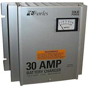

As far as I can find, Charles' labeled charges were not inverters.
The company made inverters under the Vanner brand name.
Here is a catalog that may help you. At the least, you may find the serial number and match the information to your unit.

True @Scott T-Bird .
That is why I introduced the image and other data to identify something we could discuss. The fact that the OP has not responded is another interesting piece of information.
