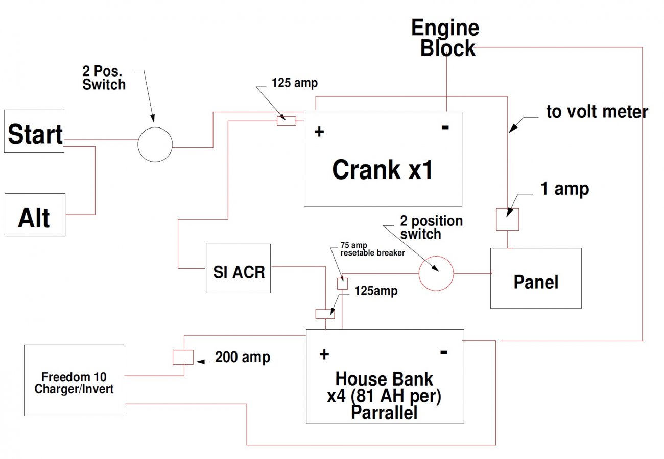

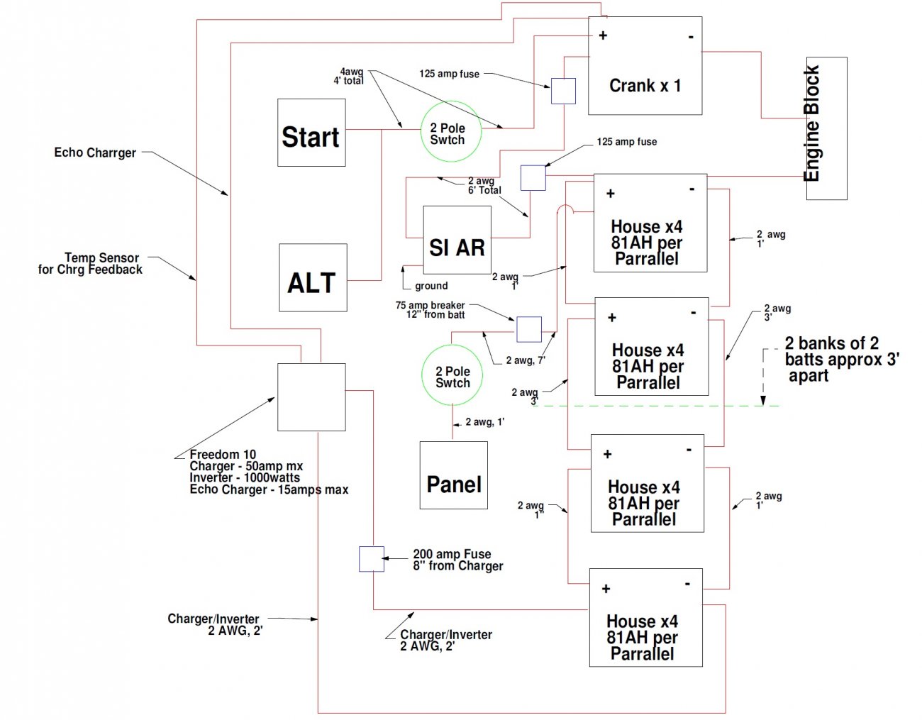

In addition to what @LeslieTroyer pointed out:
The 2AWG cable is probably a little light. While the allowable max amperage out side an engine room is 210 amps and there is a 200 amp fuse and a 75 amp breaker, however between the batteries there is no over current protection and it could potentially draw 275 amps before over current protection interrupted the circuit. If one circuit drew 175 amps and one drew 50 the current draw would exceed the ampacity rating for the 2AWG wire without tripping any breaker or blowing a fuse.
Because of the size and lengths of the cables, between the first and last battery there could be a 1% voltage drop at a 75 amp draw. Here's a calculator that will help out: http://www.genuinedealz.com/voltage-drop-calculator There would be another 1% drop between the inverter and the battery bank.
All charging sources should go to the house bank. The temperature sensor should go to the bank being charged, i.e., the house bank.
I don't think you need both an ACR and an Echocharger, while different devices, I think they serve the same purpose. See this article: https://marinehowto.com/automatic-charging-relays/
The way the batteries are currently wired, they are only sort of in parallel. Think of the path an electron takes as it leaves the battery and travels through the system. As yours is currently wired, the electron only needs to leave Battery 1 go through the circuit and return to Battery 1, it never goes near the rest of the batteries. This means the batteries will become unbalanced as Battery 1 will be used more than the other batteries. The right way is for an electron to leave Battery 1 go through the circuit and return to Battery 4 and pass through Batteries 3 and 2 before entering Battery 1 and leaving the circuit again. In this way all the batteries are used evenly and they stay in balance.
