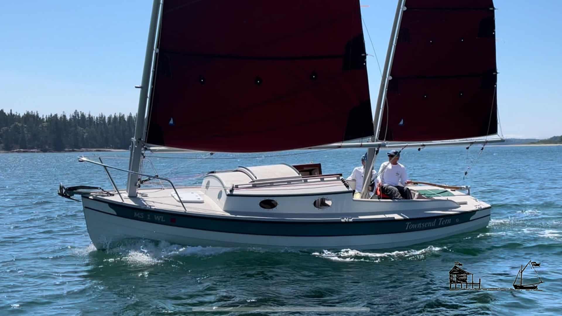

While I understand the focus is on "keeping the same boat" but altering the systems.. I can't help but query, will electric winches be enough to reduce the "strenuous activity"?
Just riding on a sail boat heeled at 15º pounding through the waves with the helm and crew holding on to a rail or line to steady themselves can be considered by a doctor in the clinic as strenuous activity.
Perhaps it is time to shrink the boat to a size that can better serve your sailing addition (I mean that in a positive way. I know the need). A boat with smaller sails would could be easier to sail. Less weight to the sails so easier to haul to the dock or raise on the mast. One of the best features is they sail in light winds so can give the experience in more manageable (less strenuous conditions).
I recently viewed this video of a Townsend Tern. I find the design and detail to function very interesting. It might be a candidate for a new more forgiving boat that mature sailors (like us) can enjoy.

I agree with John's post # 12. Maybe time for a different boat. All sailing can be work but with regard to tacking a boat with a non-overlapping jib Is a LOT less work. You might look at an Aileron 28 which is about the least physically demanding boat that I know of. In my former fleet there were several owners and crew in their mid seventies going strong.
